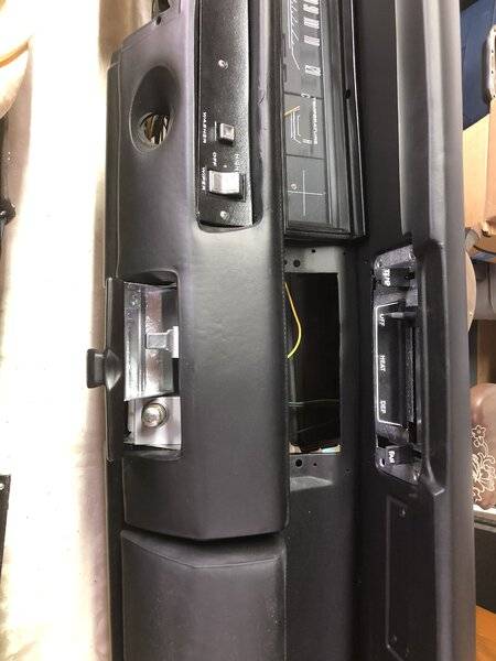

I haven't tried the VHT, but the Rustoleum Bright Finish Chrome (not aluminum) is pretty good. Check out the ash tray painted with rustoleum below. Not a perfect chrome and of course the ashtray has seen better days, but looks nice and shiny. Besides, its super cheap on amazon so worth a try.
