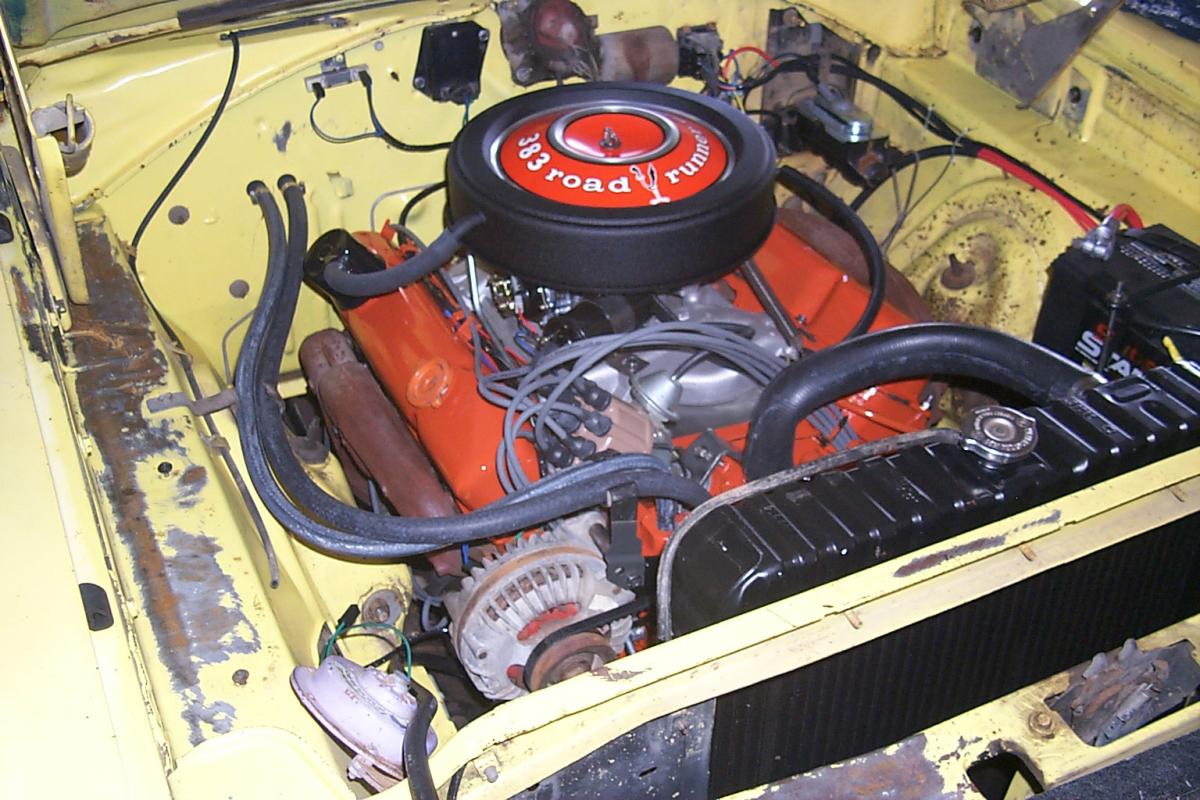

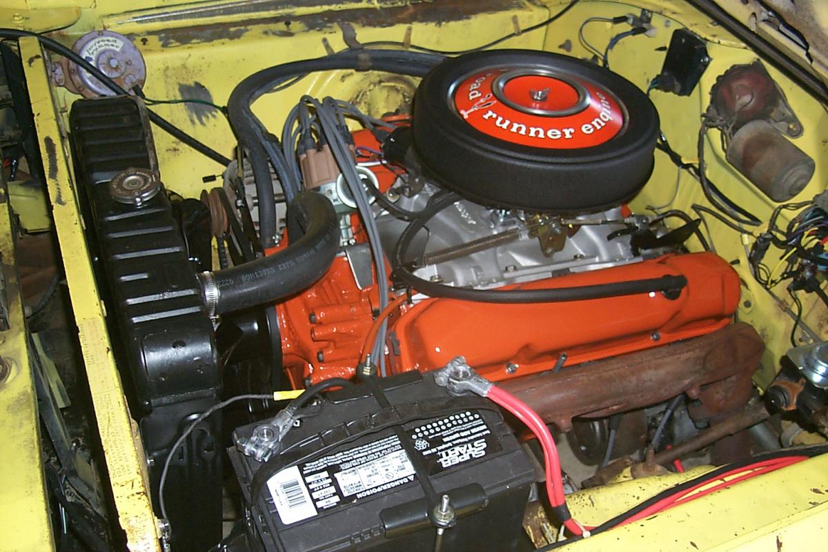

Well.....the owner came out today. I finished up the hoses and a few other lil things before pushing the car back so it's rump was outside the shop. Since the new gas tank hasn't arrived yet, a 5 gallon jug of juice and 5' of 5/16" fuel line had to fill in. And after about 15 seconds of cranking......WHOOM....it fires right up. Couldn't believe I had the rough timing so close (single point too)
Anyway, I fired up the old SnapOn dial back timing light to dial it in, then let it run for about 15 minutes @ 2000 rpm. (sounds like baking a cake doesn't it?). No rattles or creeks. A minor fuel leak at the carb and a small but annoying leak from the passenger's valve cover were all that was a problem. However, it's gonna need a new temp and oil pressure sender. A bit unnerving to fire a new motor with no gauges :rolling:
It's going home tomorrow.
