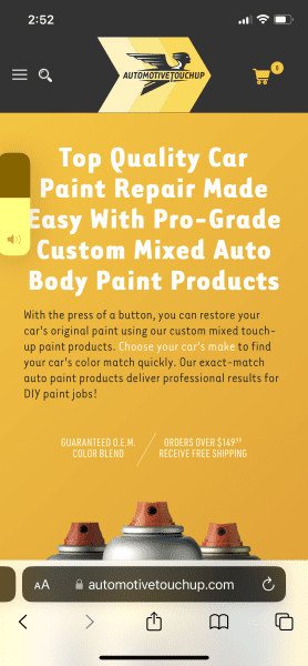

I just did this with my daughters Honda Civic. First can was totally wrong. Got refunded and purchased from another company. These are the Online exact match places. Second time around was spot on.

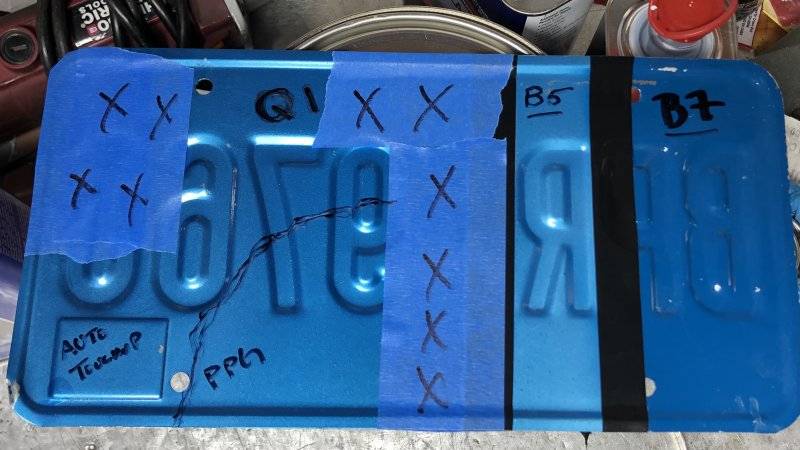

I was not ready to buy my paint and guns when I needed to paint the engine bay. I went with these guys for the rattle can base/clear and it turned out fine with a perfect match. See the pic with Q1; PPG was from the paint store and the Auto was rattle can.

Another vote for Automotive Touchup here. I used it to touch up a couple of spots on the Newport and it turned out great.
