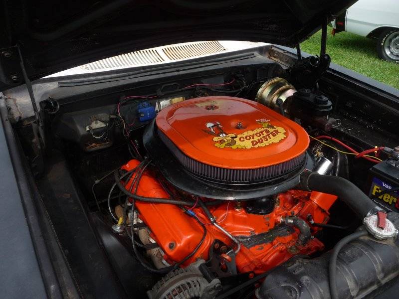

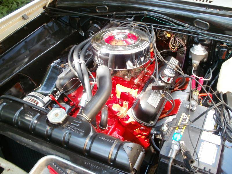

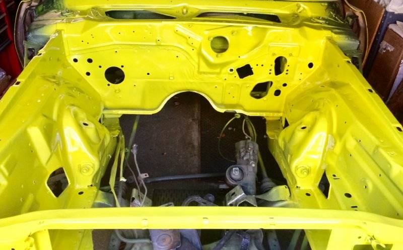

I used self etching but I am no body man. Oh, I didn't use base clear.
Oh no.... The dreaded black engine bay in a non-black car! Heresy! :poke:
I had to paint it some color and I had plans of the outside being black. Hasn't happened yet but I hate ZZ1 code.

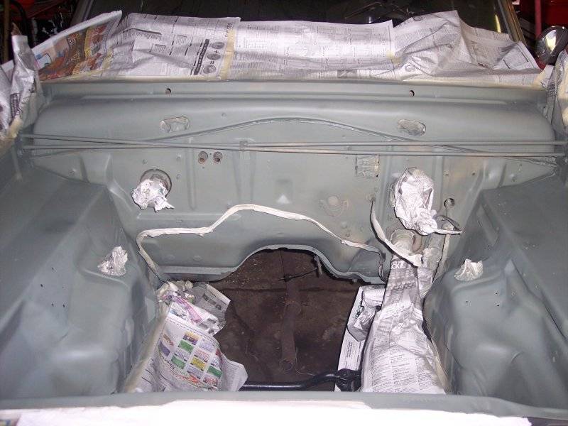

I was using Duplicolor 2-in-1 high build primer and my painter suggested I remove it and use epoxy.
Which I did!

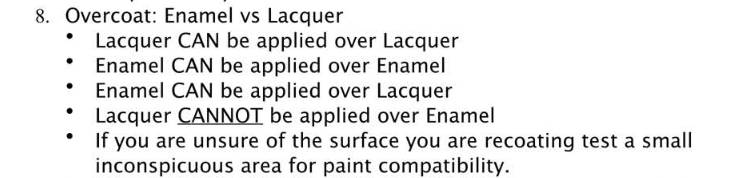

Found this on Duplicolors web site (the 2-in-1 high build primer is Lacquer based)
Any painters out there that can clear this up

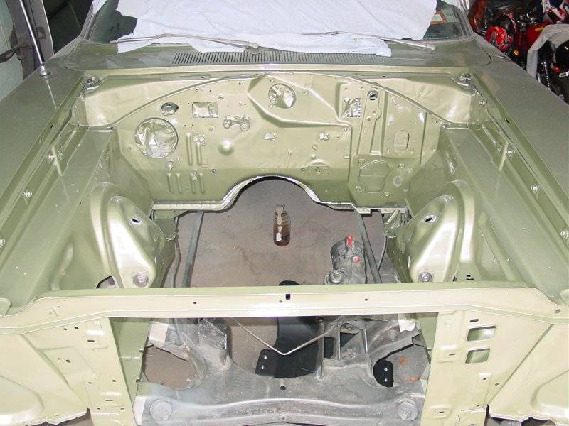

If I'm shooting the whole car in a booth, I go with a two stage paint. For just an engine compartment I prefer to use a single stage urethane over epoxy primer on clean metal. The single stage shines real nice and if you get a little dust in it, you can sand and buff it easy. Here's the last two I did.

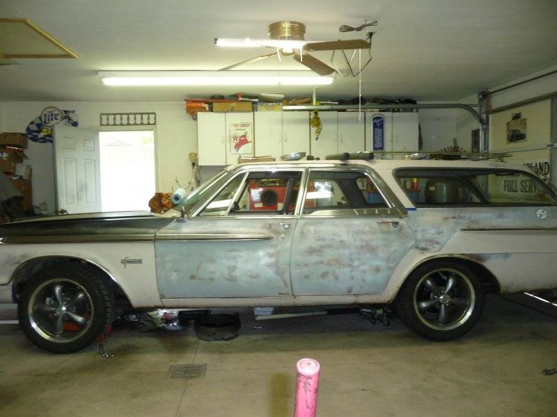

Show us some pictures of what you are painting.
Get a pint of single stage, in body color, clean up the surfaces and scuff them with some 400 or so, tape all the firewall components and engine and spray where you can get to. No rattle cans necessary.
1962 Fury wagon, 318 poly (note: black engine bay ).
Nice air cleaner!! If you are just going black on the engine compartment, then rattle can is probably good. I thought you were going with a factory color, not available in a can.
