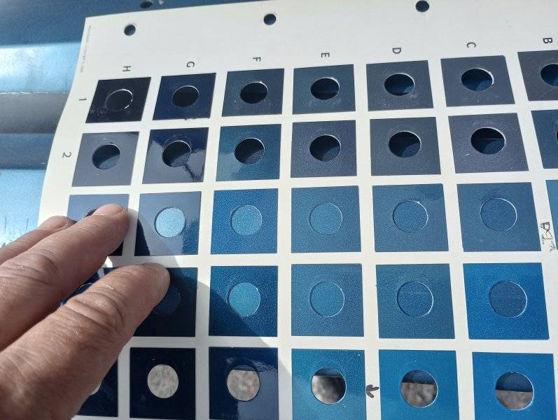

D-4 ?my paint store offers "color map" formulas....... I had an area of nice original paint under the tail panel on this deck lid, and zeroed in on it pretty good
Arrow points to E-5.
Did we sink a battleship?
the arrow was already there....... dude handed me like 5 pages, it didn't take very long to eliminate most of the chips........... I have to look at the can to see which one it was, it was a few months ago........ I remember 2 of them being very close; but one of them had a darker "side tone", as did the original color. I picked that one and will post it later........ actually, hope to be spraying a bunch of it later today/tonight

D-4 ?
When the paint store uses that color matching chart with the holes, Will the give you the paint formula also , so you wil know what it is, if ever needed ?my paint store offers "color map" formulas....... I had an area of nice original paint under the tail panel on this deck lid, and zeroed in on it pretty good
