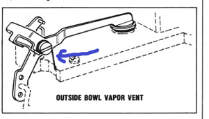

So I volunteered to rebuild a buddy's AVS for him. Like any favor it comes with challenges. :) On reassembly I noticed the small spring that pushes the bowl vent was missing from his carb. I've searched for hours to try to find someone who sells them. Any ideas? Pic to show what I'm talking about.
As always thanks for the help.

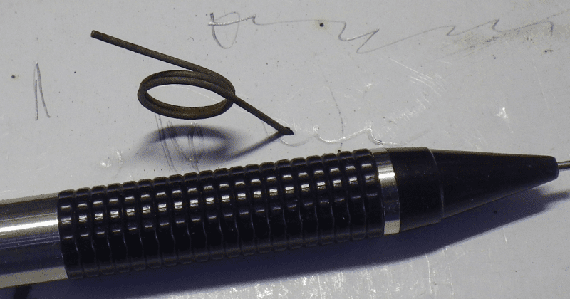

Easy to make. .027" spring wire. Two and a half tight wraps around a 7/32" drill shank. Cut end lengths to fit tab and carb notch should do it for ya'.

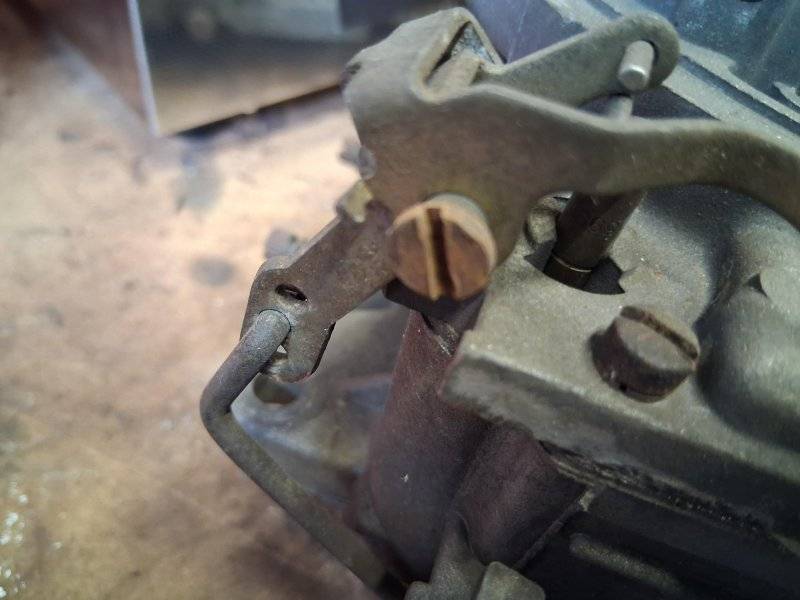

This one is heavier .032" SS wire I had laying around to try.
Original.........
