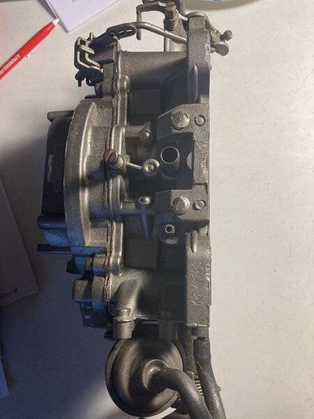

I supposedly have original Carter AVS 4618S for my 1969 Coronet RT. Looks like 2 mixture screws are plugged. Is this normal for St Louis build?
Well just heard back from Mopar Guru friend and sounds like there were several versions including mine with plugs.
Curious what other 68-69 440 owners have with this carb.
My original 1968 (built 11/67) RR 383 has the same carb body. No mixture screws - unlike the new AVS 2 I've been playing with.
The 1969 FSM shows the plugs on the AVS too. The left hand thread screw in the middle is used for idle adjustment.
Tamper proof , remove the plugs.
I had my 4429 restored and the first thing I did after getting it back was ordered aftermarket brass mixture screws like the 69-up versions typically had. Much easier to get it dialed in at idle.
The mixture screws were plugged, at final assembly after flow testing, to achieve the contracted mixture requirements of Chrysler Corp. The "idle mixture screw" was located above, as shown in your pix, and was a left hand thread configuration, which was an adjustable air bleed, when turned in, increased the mixture richness, by decreasing the air flow thru the idle circuit. I believe this feature was for 1968 model year. The following year, the system was revised to eliminate this feature, but added added an "adjustable air bleed" circuit to fix an off idle condition for emission control requirements. This "adjustable off idle air bleed" circuit was set at the factory and sealed...it was NOT an adjustment to be changed by the owner, as it was set to a differential air pressure value between the idle air flow and off idle air flow pressure.
The plugged passages shown in your pix, could be carefully removed, to expose the mixture screws inside the body casting, accessible via a small thin blade screw driver. USUALLY, turning the hidden screws COUNTERCLOCKWISE approximately 1/4 turn, resulted in a smooth idle and eliminating a stumble condition.
It is important to realize that ALL of the idle mixture fuel is derived thru the primary booster venturii clusters via fixed, non-adjustable drilled orifices in the booster venturii via drilled passages in the main body. The primary metering jets and step up rods control fuel flow only when the boosters are feeding fuel and DO NOT conttol the idle fuel flow. This is true for both the AFB and AVS carbs.
Hope this helps your understanding of the carbs operation.
BOB RENTON
BOB RENTON
