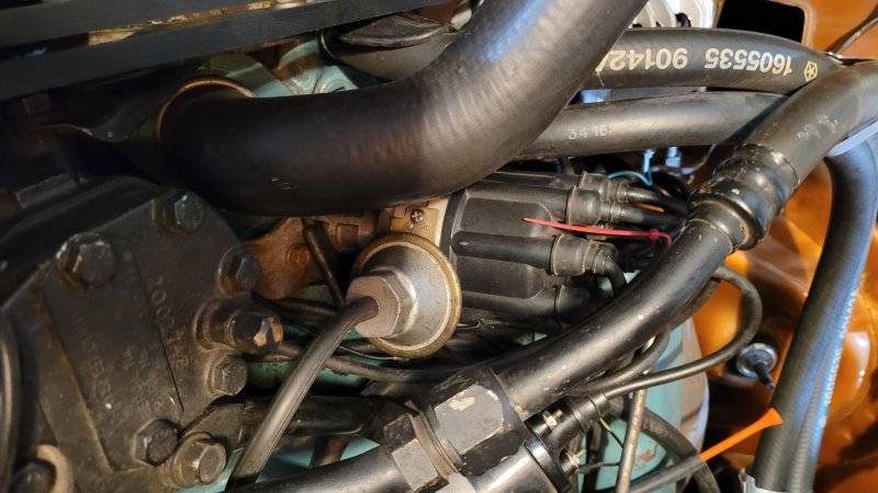

Here is a pic of the Distributor. This is the distributor that came from the Mopar Electronic Ignition upgrade kit P3690427. That kit came with the distributor, Orange ECU P4120505 and Ballast Resistor P5206436. It was purchased in 1988. I should also note the Coil is original stock. After years of cleaning for car shows the white part number is gone so I can't confirm the number.
It does appear to have the hex portion at the nipple but not sure how that makes it adjustable. If it is then will wait for your extra information.
If it is NOT adjustable then I would need information on the option of converting/adding an adjustable vacuum advance. Also you said decision time but you didn't really say what the option is if I don't go to an adjustable vacuum advance.
