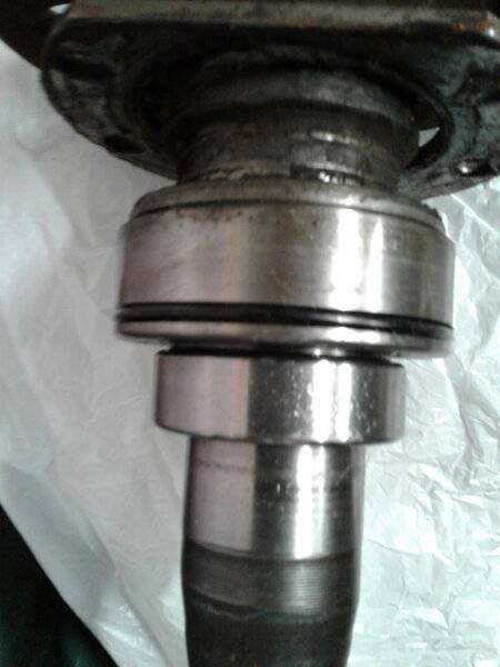

A bunch of years ago I bought a set of axles with new bearings.
Is there a way to tell what kind of bearings they are, whether they are green bearings or OEM?
Thanks
Those are plain old ball/roller bearing "greens" with the O ring. I believe the newer ones use a snap ring and those O ring ones were the common failure style.. but I've been wrong before...

Actually, from what I know that’s not all that bad of news. I think the worse part of replacing tapered bearings is removing the old ones. Someone has already done that for you so you could remove those green bearings and press on new tapered bearings if you are so inclined.
