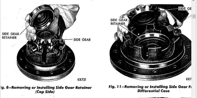

If you had the SG apart and side gears splines aren't lined up you won't get the axles in. I had that happen on one side, had to make a rig to turn axle and try to slide axle in. Yoke has to be held while turning axle. Used a piece of tape to see if axle was in all the way. It was turn axle a little and push it in, got it on 2nd try.

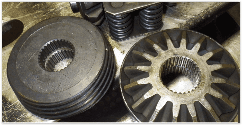

If you have a clutch style posi (oh snap! Sure grip!) you have to align all the clutches and side gears splines during assy of the limited slip unit (hah! See what I did there!) You either have to have stub axles, or the actual axles to line everything up during final bolt-together. Otherwise spline miss-alignment won't let the axles in all the way.
You need to do as Fran did, overcome the internal clutch friction with leverage to align the splines while pushing in the axles, .....or pull the whole thing apart and re-do. I would make whoever re-did the Sure grip fix it.
As I said this MAYBE your problem. Your axles could be in Side Gear Retainer but the Side Gear splines may not be lined up with the Side Gear Retainer splines. You only need a 3/4 foot lever to turn axle in setup like mine, didn't known how much force was needed to turn side gear retainer. This may not be your problem, I'd wait for any ideas I missed.
Same on the cone LSD.
If it helps, a cone set from a "489", one turned up one down. If one or both "sets" of splines on either side are not lined up, the axles won't slide into the inner geared spline.......
