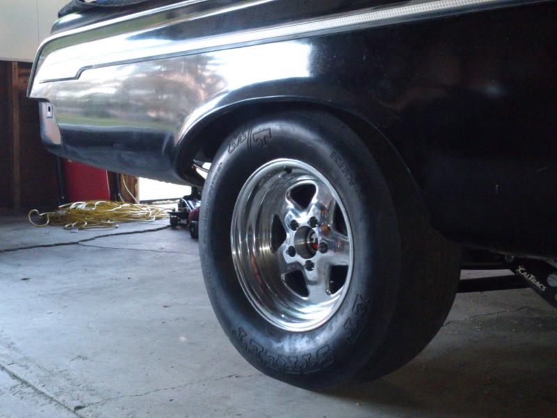

I used the rear from a '70 Charger in my '63. It was slightly wider but worked out perfectly for the wheel offset that I'm running.
It's a bolt in swap as the perches are the same width apart, you just can't use the later (longer) leaf springs.
$900 isn't bad if it includes the third member and a decent set of gears.
I've got around $1500 in mine all told but it has brand new everything.
I should have bit the bullet and went Dana but I was too far down the 8 3/4 road to turn back...
