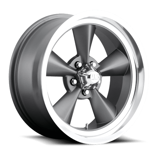

I've finally decided on these 17" wheels, US MAGS U102.
dfpWfSHR1OW30spoi7ah1v1FK6Ufjrc5UqJiEZQGCKaLxDcsNI8WQqow74En3SGEDJqe1CKi59vI-TLzKPtrjH4v5uKz3WYo.png
I think they look good at a price point that doesn't break the bank.

My absolute favorite wheels of all time! The original t70r was only made for two years, so very rare. Then they brought them back, in more and larger sizes. Hooray! I went looking for a good price on some , a few weeks ago, and they are discontinued again. Hold on to yours!

Totally agree.
I think I just found my Rim. Thanks Larry. I'll research it.
Hopefully they come in the sizes I need with variable back sets.
Totally agree.
They do come in 15",17", 18" and 20", varying widths and backspacing.
I found a decent deal locally in So. Cal for a set of these with Nitto 555 G2 235/45-17 (front) & 275/50-17 (rear) mounted and balanced.

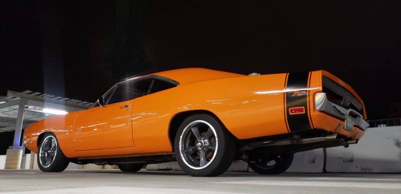

Nice wheels. Although I think mine are a cheap copy that was formerly sold exclusively at Discount/America's Tire and are in 18". If I could do it over again, I'd go with the 17"...

Curious, what don't you like about the 18" wheels? I'm glad to be moving up to 17" from 15" mainly for performance tire options, but it was my goal to eventually get 18". This is all performance oriented and there's a pair of wheels that I really want at 18" that I'll pay money for. Your ride looks great and I've seen plenty of Mopars that look good with 18" wheels.

Thank you, I appreciate it. Well the main problem I have with this particular wheel in 18" is the lack of width. I wanted my back wheels to be 9, maybe 10 inches but this particular wheel only comes in 7 or 8 inch widths at 18". If I had gone with 17" I could've had a 9.5" wide rear tire. Now that I look at discount tire's website, that wheel looks to be on the way out, inventory wise.

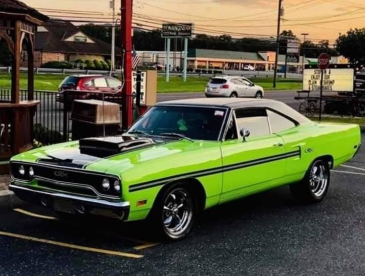

That is not only a beautiful car but nicely set up. What wheels are those and what backspacing?
American Racing Torque Thrust 2's (CHROME PVD)
17x7 4"b/s
18x10 5" 1/2 b/s
If I remember the wheels specs correctly
I had them customed done!

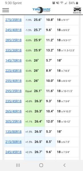

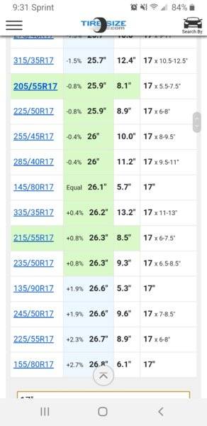

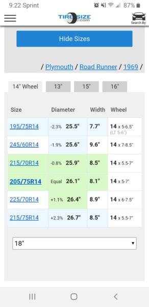

A little info if anyone is curious. F70-14 is basically 205/75 R14 and 295/35 R18 is almost the exact same diameter.
F70-14 = 26.2x8.3
205/75 R14 = 26.1x8.1
295/35 R18 = 26.1x11.6
