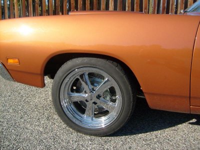

This looks killer! Did you have to use a rear leaf spring relocation kit to fit the 17x9" in the rear? Do you know the rear's offset or backspacing?
Thanks, Drew
Suspension wasn't adjusted but you get the idea oh there 18's 18x8 18x9.5 people couldn't stop talking about the wheels. I liked it so much I'm doing the same thing agen
Did you have to relocate the leaf springs for the rear? Do you know the rear backspacing or offset?
0 offset wheels , no spring relocate kit and the springs are Hotchkis units with plenty of room to spare .S6300753.jpg

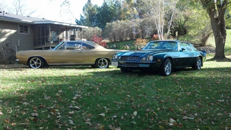

Well mines a 72, and I want 18s out back, but Ive done a lot of research and decided on the top setup in this picture (PVD finish aka black chrome). Sorry for the poor quality photoshopping but it gave me a good tool to help decide
I'll be honest with you Tommy, I have never been a big fan of the Runners beyond 70. I'm a 68-70 snob.
With that said, your rim choice on that machine makes for a pretty bad-@ss looking bird.
Love the subtle stripes in the paint work.

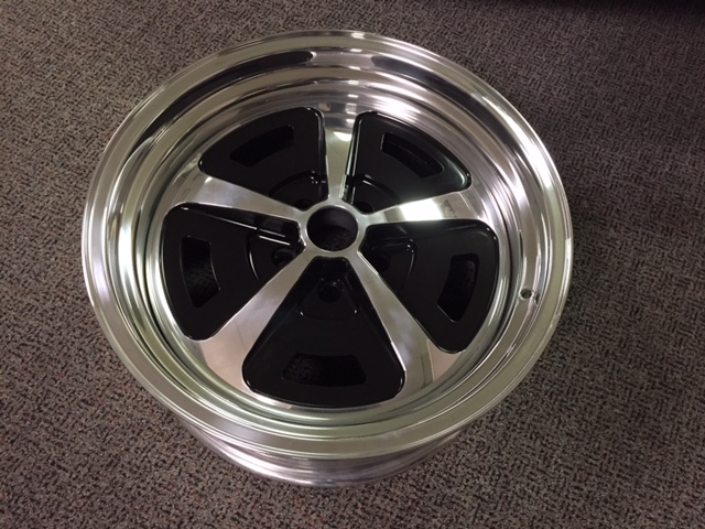

I just had these delivered from Summit, 18 inch Circle Racing wheels that are going on my 69 RR build. I figure the classic styling cancels out the so called hoopty type vibe. I think these are going to look great! 18x8 front, 18x9.5 rears.

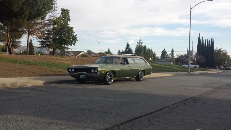

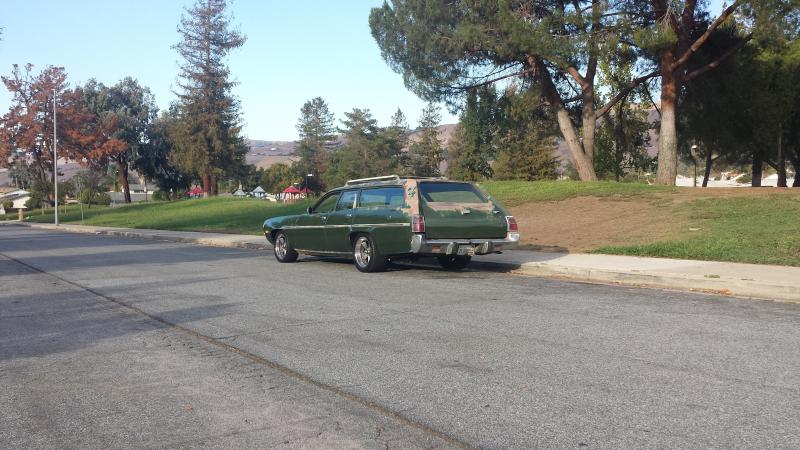

Front 17x8 4.75 backspace 255/40 (better aesthetically if was 4.5)
Rear 17x9.5 5.5 backspace 285/40 (backspace works well on this car because the wagon has a wider rear axle)
Daily driver, no rubbing. ;-)

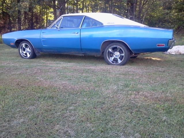

here's my 70 with old school 17's all around. 245/4017 front, 275/40/17 out back 17x8 front 17x9.5 rearcharger profile.jpg2015-09-16 17.14.22.jpg
