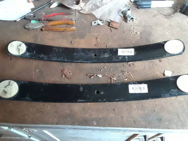

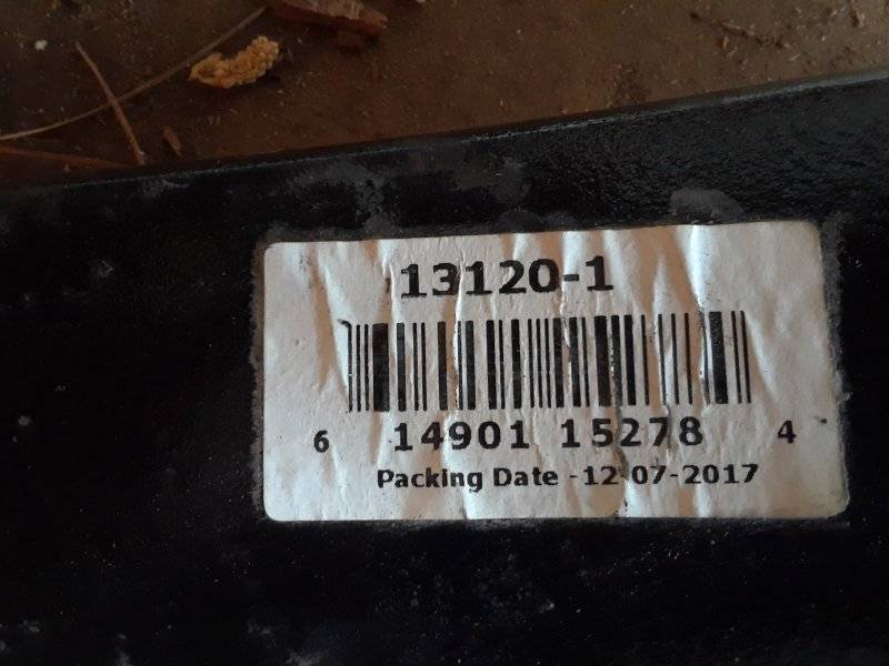

I took out a set of helper springs from my 64 Polara. Dropped the back end close to 1 3/4 inches. They're cheap and summit lists them under item #13120-1

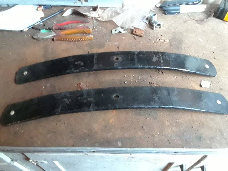

This add a leaf helper springs were installed at the bottom of the spring pack - i.e. - closest to the ground. The ones on my car had replaced the OEM "short" leaf.

The add a leaf pictured would be the shortest leaf in the stacked pack - so it would only go on the bottom of the leaf stack.
