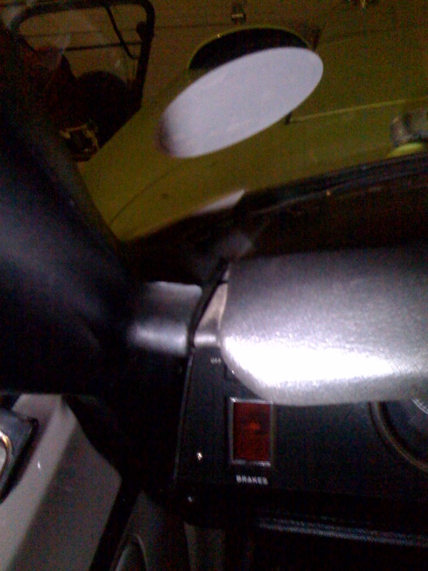

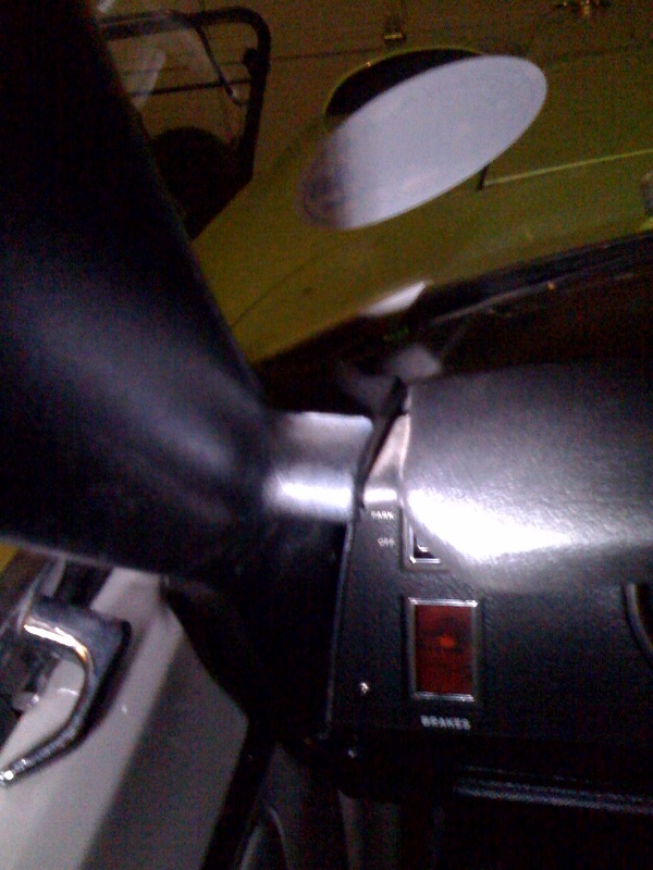

i have bought several reproductions ones and they are all about a 1/2 to short on the ends , they dont fit up snug in the a pillar moldings like the originals do .

the ones i got have the metal reinforcment at all , they look great and have the correct grain and fit fine but are short on the ends
i looked up my reciepts one came from P&G ( same stuff as BE&A ) and one came from year one another from hardens . all fit about the same

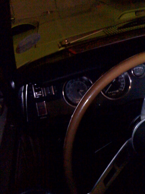

ok sorry for the bad cell phone pictures but I just ran out in the cold garage and took these , this one came from P&G and is installed in the 70 superbird convertible

it fits the exact same way on the passenger side , and the year one pad does the same thing in my 69 charger

BE&A and P&G use the same molds and suppliers for there parts !! mike at BE&A does have a much better quality controll and return policy !!!!

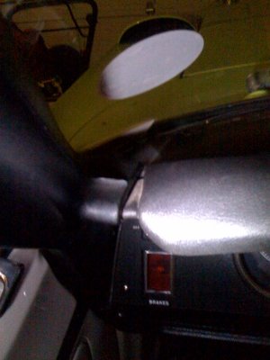

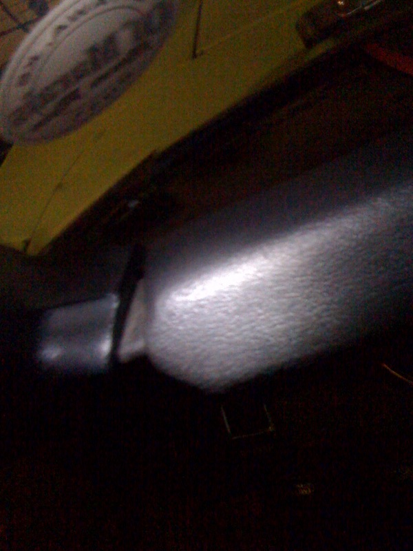

If the use the same molds, do not buy from either, their molds are not correct. They are a 1/2" off on the corners, see my thread about dashpads.
Here is what I am talking about.
