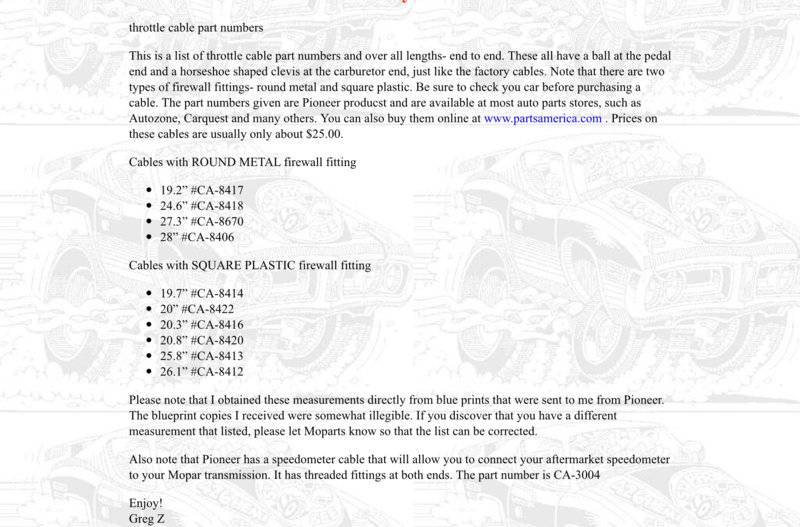

I also found this on another site if it helps. Autozone or napa can get Pioneer cables.
What makes the over-all-length? cable end-to-end or the jacket end-to-end?
Because also Summit Racing sells the CA-8418 cable which is a few inches longer then original.

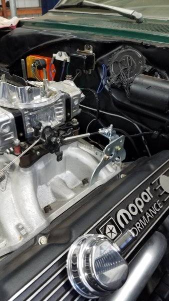

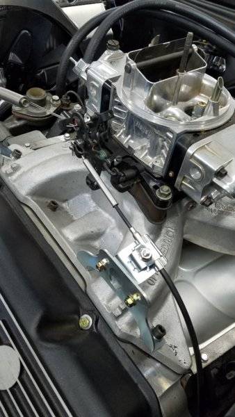

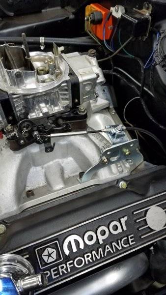

I am happy to say that I put the throttle cable, adjustable bracket and return spring set up on tonite after work. I feel that is is a high quality, user friendly set up that will work for a very long time!
I got the cable that was 21 inches overall and would not go any shorter, maybe a whiskey longer.

Thx for the update.
Your setup looks clean and neat!
