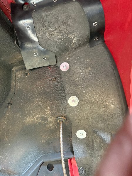

Installed the back front fender splash shields, did my dash still need to install vin plate. Crack looks worse then it is,passenger side of block. Think Im going to strip it down to see if cracked
inside. Then go from there.
