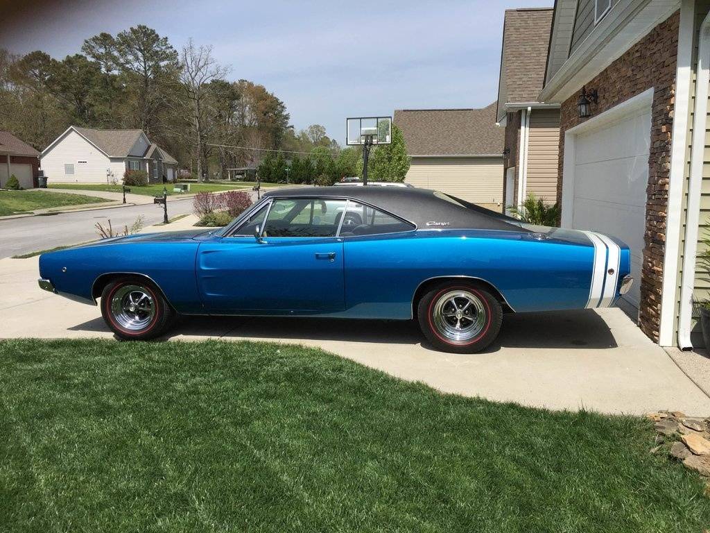

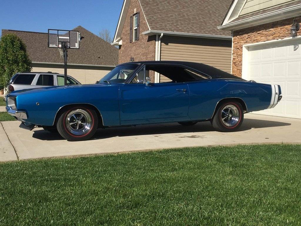

Welcome to FBBO - sounds like you have a problem project on your hands. How about pics of the car.......
won the world of wheels mopar of the show Chattanooga 2016
welcome to FBBO nice looking charger good luck with your brakes

Nice looken' 68 Charger

Welcome, beautiful Charger, and good luck. Guys on here will point you in the right direction.

Beautiful car by the way!
