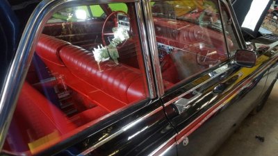

more photos shortly, I know incorrect mirrors etc but will fix all that when I get her...
Wow great looking car. Love that red interior. I'm hoping to put a third pedal and 5-speed in my 65 Coronet someday.
