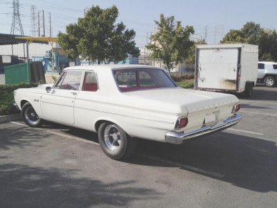

i just put new wheel vintiques steelies on the rear of my 65 15x8 with 4 1/2 backspace with a L-60 tire plenty of room to spare for bigger tire in the future if i want.

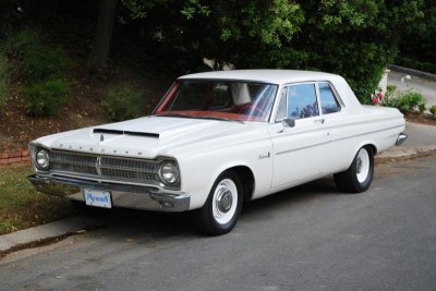

Thanks Hit It... Here is the previous look... Slightly less offset 4 3/8" with steelies...
It looks great both ways! both wheel look nice.
