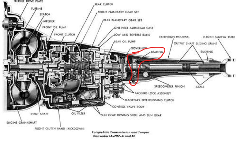

long shot, but you could listen to the tail shaft with a stethoscope. The diff too. harmonics can travel through things

I read through that. I could try replacing the tailshaft bearing and the rear end seal he mentioned. I believe my angles are correct but will triple check!

I may have missed someone else suggesting this, but I would check the rear shaft bearing. Not hard to do with it in the car.

The tail-shaft bearing seems like a logical place to look. So does engine balance. Was the engine precision balanced or simply put together with off-the-shelf parts?

I’ve ordered the rear bearing and will give that a shot next. I’ve also seen some folks with the tail shaft weight dampener installed. Do you think it’s worth throwing one of those on as well?
