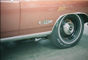

By the way, those are the same wheels and hubcaps that are currently, still,on the car.
