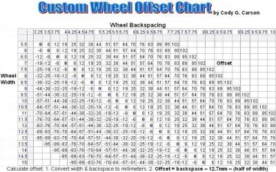

But that isn't correct using the backspace calculators on the internet. Here's one: http://www.mrw-wheels.com/wheel tech/offset chart.html
Put in a 10" wheel with 0mm offset and the backspacing shows as 5.5". How is that possible if the mounting surface is in the center of a 10" wheel? Worse, how can the backspacing be 5.5" and the "front of wheel" be 5.5". That adds to 11" and the wheel is only 10" wide.
Put in an 8" wheel and the same is true! The total backspace and front space is always 1" greater than the width of the wheel. WTF?

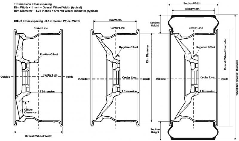

An eight in wheel is 8 inches on the tire bead the off set is measured from the outside lip so an eight rim is close to nine inches to out side of lip
Grabinov911, your 10" wheel is ten inches as measured on the inside of the lip, meaning the tire beads will be ten inches apart. However, the outside of the wheel as measured from lip edge to edge will be eleven inches. It's the inner rim size that is usually mentioned, but the outer rim will be what gets closest to your springs or other areas of interference.

I use this.

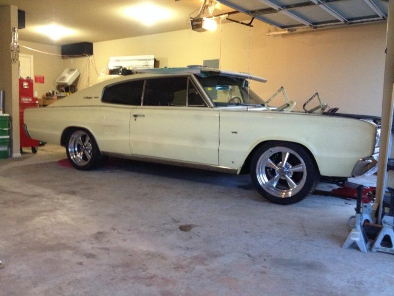

Cragar SS all aluminum 612 in -12MM offset in 18X9.5 front and rear with 265x35x18 front and 285x35x18 rear. If the Wilwood brakes would not have pushed the rim out 1/2 and inch I could have gone with 285x35x18 front and rear. Granted the 285 leaves too much room in the rear wheel well but Cragar does not make an 18 in anything wider than a 9.5. Trust me I called and talked to the techs 3 times to make sure.

That offset chart is awesome....would have saved me hours of searching if I had that from the beginning.
