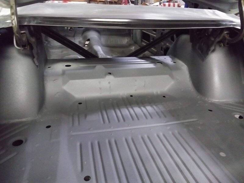

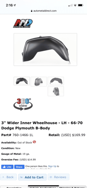

I have a 69 Plymouth Roadrunner (383 4-speed , A4 Metallic Silver , Air grabber car ) it is currently in the shop. Metal , body work and paint . 3 inch wider than factory inner wheel well housings have been installed .( Auto Metal Direct ) I want to fit the widest tire possible in the back . Has anyone on this forum installed these and if so what is the widest rim size ( 15’s) that I can put on the car . Can you also tell me the offset and backspacing please . I have looked it up but i am still not certain about figuring it out . I am sure 15x10’s would work for the back but again I am not sure . Any help is appreciated . Thank you

did you do a spring relocation inward too ?
did you narrow the rear end axle housing too ?
you can easily fit a 295/50/15 on a 10" wide wheel
or bigger in a stock wheel well, if you have the proper backspacing
you can probably, fit a 12" wide wheel (easily) & a 345/55/15
or possibly Maybe ? even 390/50/15 tire & wheel combo
especially if the springs have been moved inward, with the inner tubs mods
but need to measure for your specific application
if the rear axle housing is narrowed,
then possibly custom application
need to measure from the most outside part of the drum/disc
whatever applies to your car, back to the frame or spring
whichever is closer inside the wheel well
or the frame or the inner tubs, whatever is closest to rub
& to the upper outside portion of the inner wheel tubs
be careful the outside portion on the wheel tub
has a drastic bump/flat portion up toward the top,
so it will depend on how low the car sits
or how high up in the suspension travels
or it can rub on the inside outer/iupper portion of the wheel tubs
good luck
