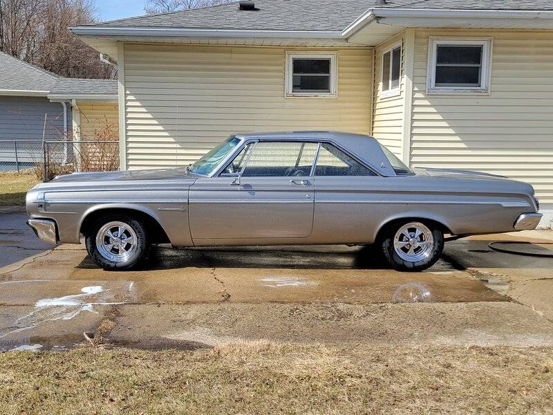

Im running kumho ecsta 245/ 50 zr17 99w all the way around. They ride on 17" American racing wheels. I like them!

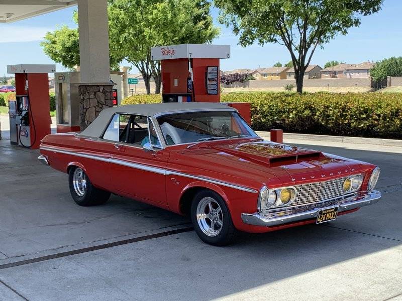

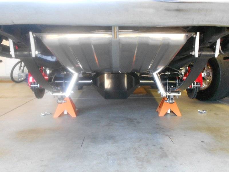

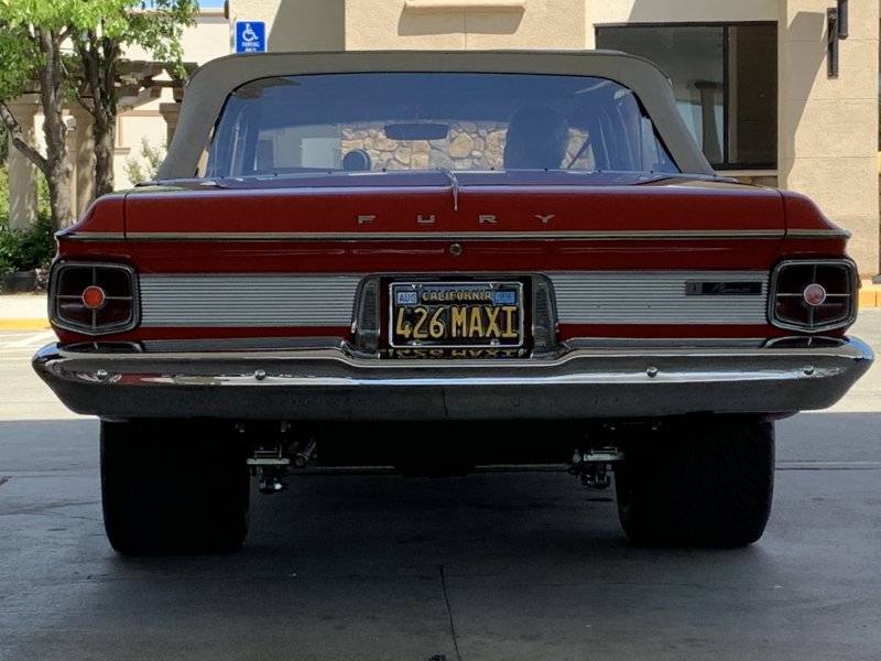

OP said he liked BIG tires, right HEMI-ITIS?

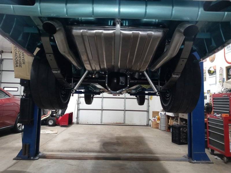

On my 63 Fury: M/T 29X15x15 (15" at the widest point on sidewalls) (13" tread width)
Billet Specialties Streetlite 15"X12" wheels 4.5"B/S
Moser Fabbed & narrowed 8.75" rear, Calvert mono springs moved under frame rails .
