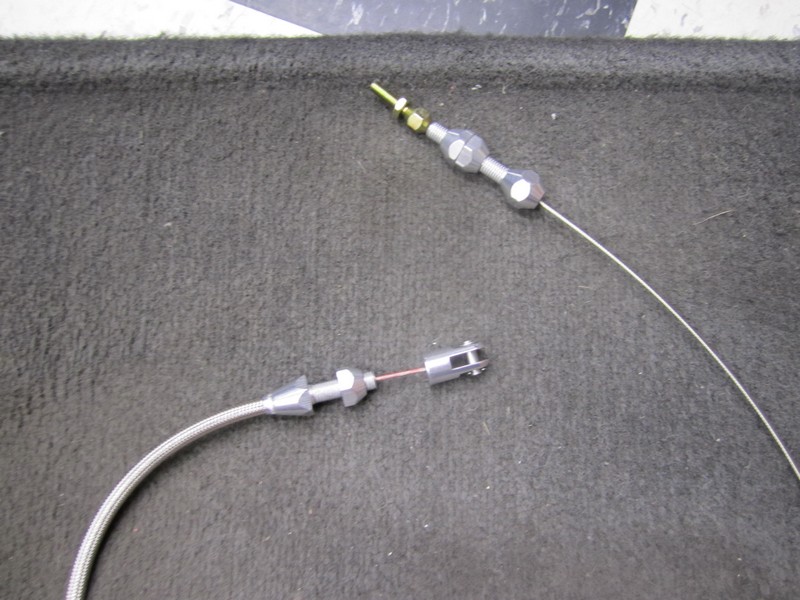

also I ordered a lokar braided stainless...or black?:argue:

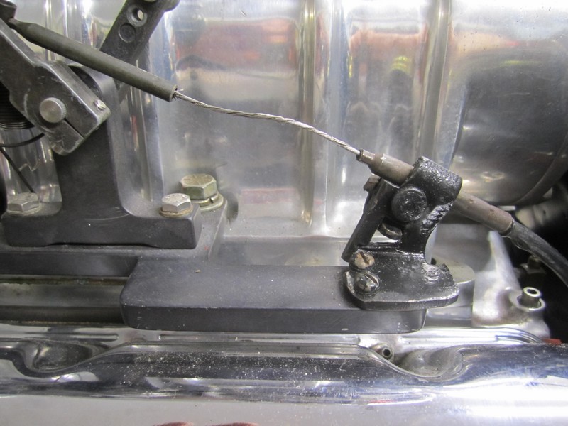

Once those strands start popin',They also bunch uo down below where it comes through the firewall.When that happened to be,the throttle stuck wide open and I stained my panties.Ended up turning the key off to stop:eek:

my 440 belvy did that. what was happening was.....when i got on it pretty good, the torque would pull on the clamp that holds the throttle cable to the block. .....then it would idle really fast until i loosened the clamp nut then it would go back to normal idle. i chained down the drivers side on the engine...( actually i used braided stainless steel cable with saddle clamps )....fixxed the prob. now i can terrorize the neighborhood again .! lol

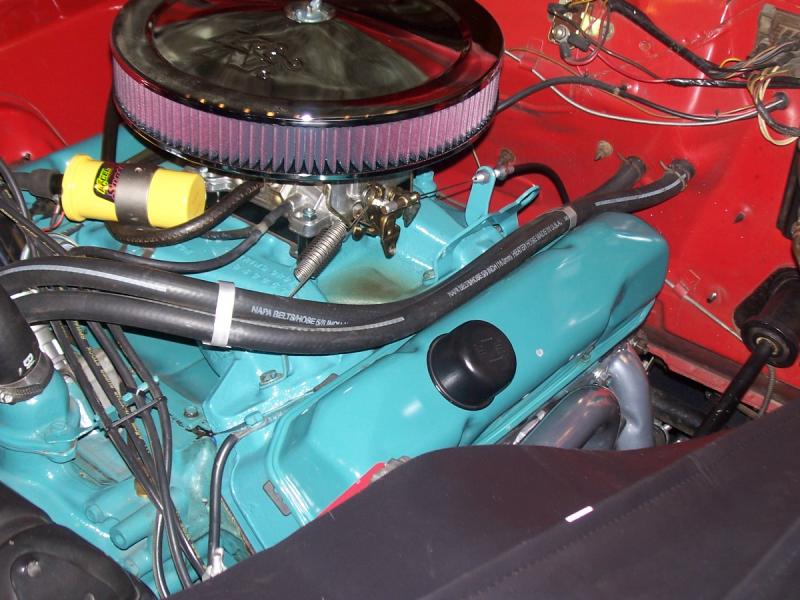

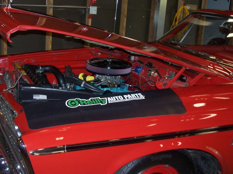

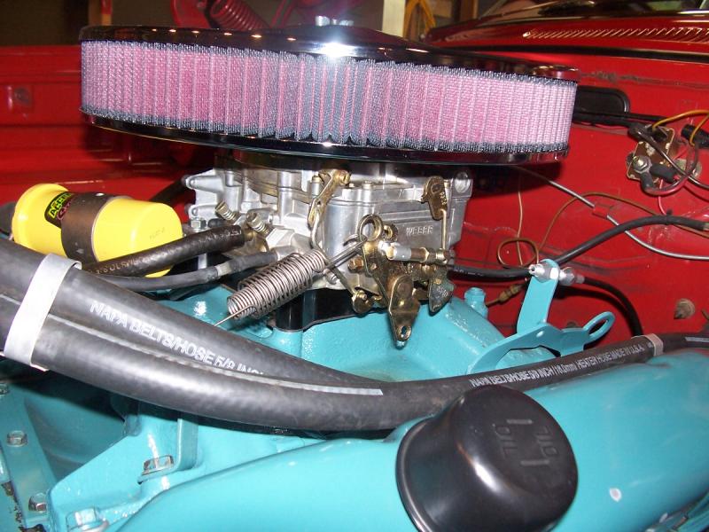

new lokar throttle cable and new "duel" return spring....a little
tweak and it responds great..thanks for the input!
sonny

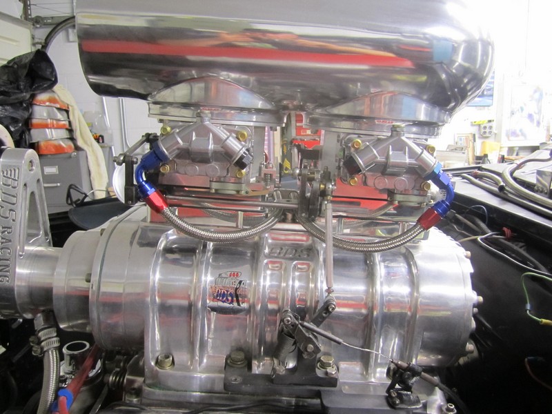

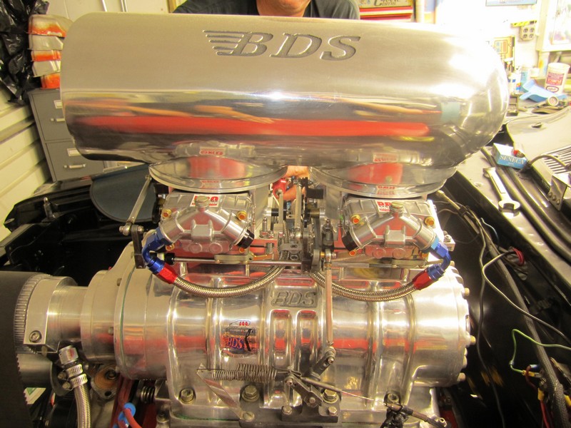

Here is a picture of new "set up".......
Sonny:sunny:
