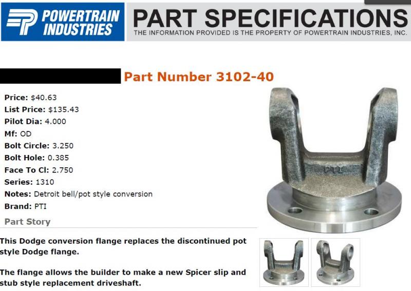

heres a pic 633.jpgfound one at powertrain industries part no. 3102-40 ship will be in 2 days let yall know if it fits price is 81.00 plus shipping there is a picture of it on foward look web site forum

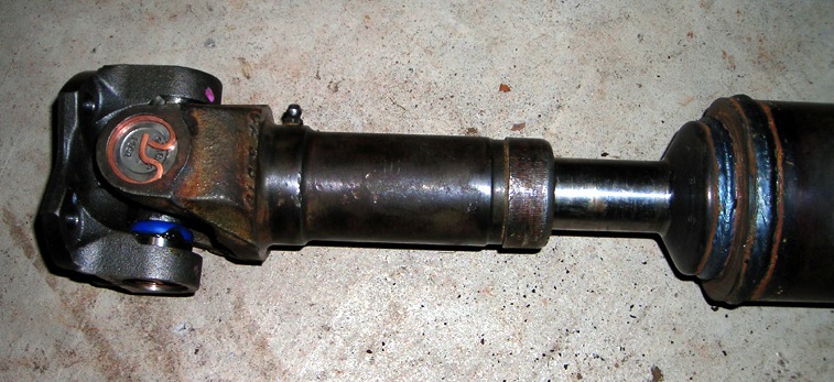

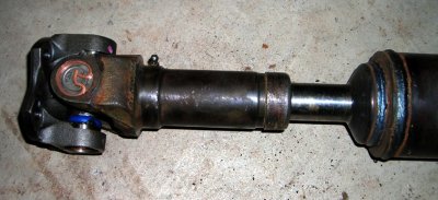

077.jpg heres the rest of the set up for the conversion. this flange is for six trans.
Are those for auto's or 4-spd's or both? i have 4-spd. John
my understanding is that it fits 3,4,and auto trans. i have all three i will let you know
Use the spicer flange (in the complete pic which is the 2-2-349), especially if you are racing it, the above flange in the pti pic i wouldn't trust behind something somewhat abusive
Are you sure that's the right one,he said he tried that and had no luck. do you know what the spec's are on the flange on the trans? bolt circle diam. etc. Thanks for any info,just don't want to buy wrong one. John
bolt circle is 2.875, the pilot is machined on the outside of the flange and should be 3.750 , the corners of the 2-2-349 center the flange in the pilot of the trans comp flange. The stub and slip vary depending on tube of the shaft but the joint will be 1310 series.
He has the large detroit 4" let me look up that flange
Ok the other flange is discontinued, ok so that leaves the 2-2-329 for the small detroit and the large detroit either the pti stuff or see a machine shop and have plate made for the 2-2-329.
