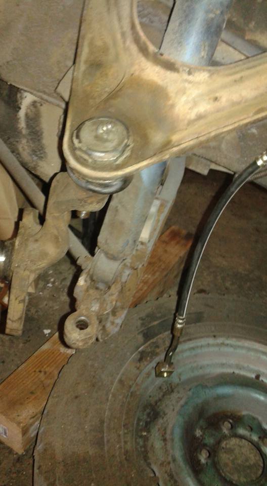

Ok, what size socket do i need to remove this upper ball joint on a 69 Bee? I assume 70 bee would be the same? Someone tells me they used about three different size sockets to get these ball joints out. I am using 3/4 drive rachet. Anyone know what size i need to purchase??? Thanks.
Yup...but if you don't want to buy one, you should be able to borrow one from a local auto parts house.....
It would be the middle size ball joint socket.
I have 2 different sizes one is a Matco #SPS32 and a larger Cornwell # WH33. I think the matco socket is the one but I can take them home and check. i'll post later and let you know.
1-15/16 Socket.
A regular socket will not work correctly. The ball joint is round with 4 flats on it, so a 6 or 12 point won't fit. It requires a special ball joint socket to fit properly.
yea i know, that is the size of the Ball joint socket
