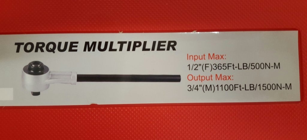

I use a torque multiplier on them when they are really stuck
Coffee usually helps when the output is weak.....
Yeah, Torque Multiplier. Used these at my job. Great piece of equipment if you can get your hands on one for a decent price! I also like to use heat to reduce the fit on the
ball-joint before spinning them out. They've been in there for a long time! Anything to break up the rust in the threads. Good luck!
