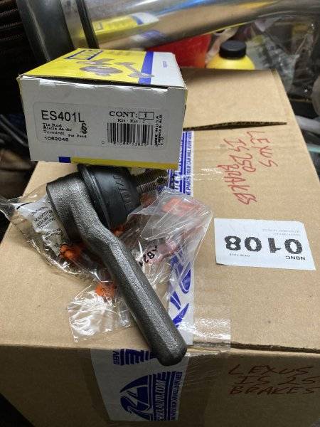

Moog ES401L Tie rod end - received with no threads on stem

If you look at that MOOG tie rod box above, on the label , you will see a 7 digit number — in this case — 1062046…
That is the run number on that particular run of parts…
MOOG U.S.A. —- as in St.Louis , Missouri , where they are headquartered, and their first and primary Manufacturing Plant still exists —- confirmed that one run of the MOPAR threaded Upper Ball Joint —- the K 772 —- run number
15.. … something, was set up incorrectly , and is too thin…
They are well aware of the situation, and like any recall situation, they apologize and will happily take them back for replacement…
