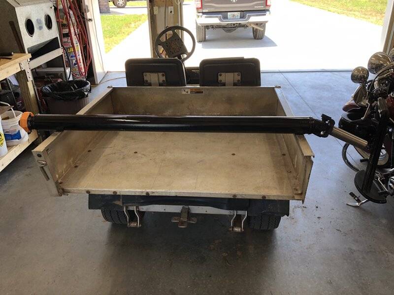

I already traded the driveshaft for a 65 rear end but you could shorten the wheelbase by about 1” by swapping in set of front spring hangers from a Plymouth. That’s how Mopar changed the wheelbase between Dodge and Plymouth. Btw, here’s a picture of The new driveshaft that I just had made. Everything is new with all Spicer parts.
Thanks for responding. I didn’t know about the different spring hangers. Good to know. Little by little I am building my Mopar knowledge. I was surprised the 4 speed takes a different driveshaft since the three speed manual and automatic were apparently the same. As a 63 my car was a T85 three speed originally. Until I find one of those, I thought I’d run a four speed. Turns out that is a bigger deal than just the transmission. Even the crossmember and tranny mounts are different.
your new shaft will work nicely. I had an aluminum one in a race car for years that was custom made to my dimensions.
