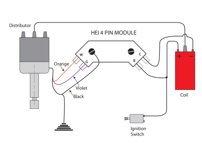

So I take it your answer to my question is "no, you don't need a ballast if you have a 12V coil"?Well EBooger has a wealth of input and knowledge concerning our MOPARS and such. But I have to disagree here Kern on that his claim of keeping it because he claims so, is bunk. I have a FBO electronic ignition box and eliminated the MOPAR Chrome box I was using. Has a built in circuit for a Rev Limiter that is built into it. They suggest by-passing the BR all together as it isn't required for their set up. So I just eliminated the internal parts of the BR and jumped the plug points with a correct gauge wire thus taking it out of circuit. It is still there for the aesthetics if you will, but doesn't come into circuit play at all. I also had FBO re-curve and set my distributor which is a MOPAR Electronic Distributor to a more friendly setting for my '66 Plymouth Satellite. I have zero problems with my ignition electronics. I would also suggest to stop using the Orange MOPAR boxes. They are not reliable and tend to fail at the drop of a hat. The Chrome MOPAR boxes are far better but they also have been known to fail. Although less frequently than the Orange boxes. I have a spare regular points/condenser distributor that I re-curved myself and a spare coil and BR so that I can re-install them in the event of total ignition failure. By the way I use a Pertronix top of the line Coil. I am some what of a self taught electrical geek and I fully understand how these systems for our MOPARS are wired together and how they operate. By studying this area, I pretty much get it when it comes to a stock correct look, and making the system far better than stock without degrading what most seek as correct. Seriously, take a look at the links her and upgrade to a newer, better, and much more reliable electrical circuitry. You won't regret it...cr8crshr/Bill

Yep if you decide to go with the FBO setup. Check out their web site and read about their suggestions. As I said I went according to their suggestions and have zero issues at all with my electronics and ignition...cr8crshr/BillSo I take it your answer to my question is "no, you don't need a ballast if you have a 12V coil"?
