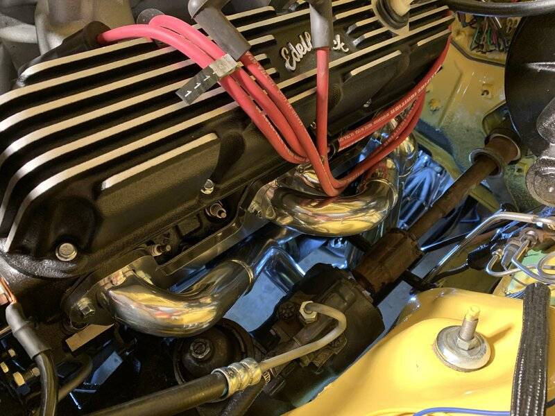

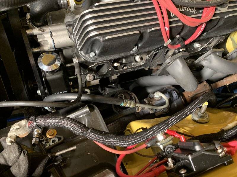

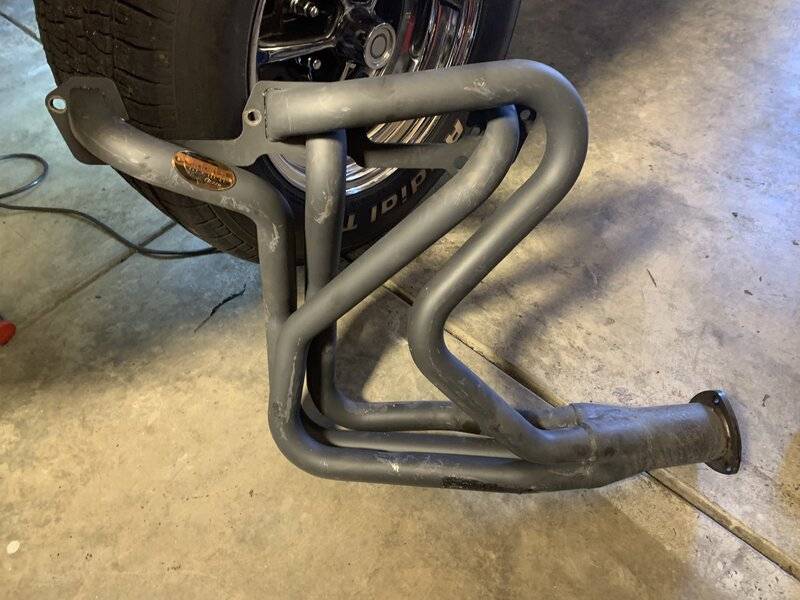

I wrangled the headers in place and temporarily hooked them up to the existing exhaust system. After that I filled up the Banana with all the fluids and checked everything but after months of sitting around with only occasional charging the battery was low. It would crank over slowly and I discovered the MSD ignition system doesn't work with voltages below 9VDC. Unfortunately I had to leave it at that as I had to go travel for work.
When I got back I went right to work and had a fully charged battery and after a few tweaks (And fixes) I got her started! I set the initial timing and performed the recommended 30 minute break in. Then I set the total timing per BPE instructions, set the idle mixture and RPM and now shes purring nicely.
I need to finish the brakes and the stereo install then she'll be ready to drive. I also need to do some tweaks, (OK, lots of tweaks) finish the AC installation, install the hood and have the new exhaust system installed. Not to mention clean up my garage and give my other classic (1979 Ford F350 4x4 Ranger Lariat) some love.
