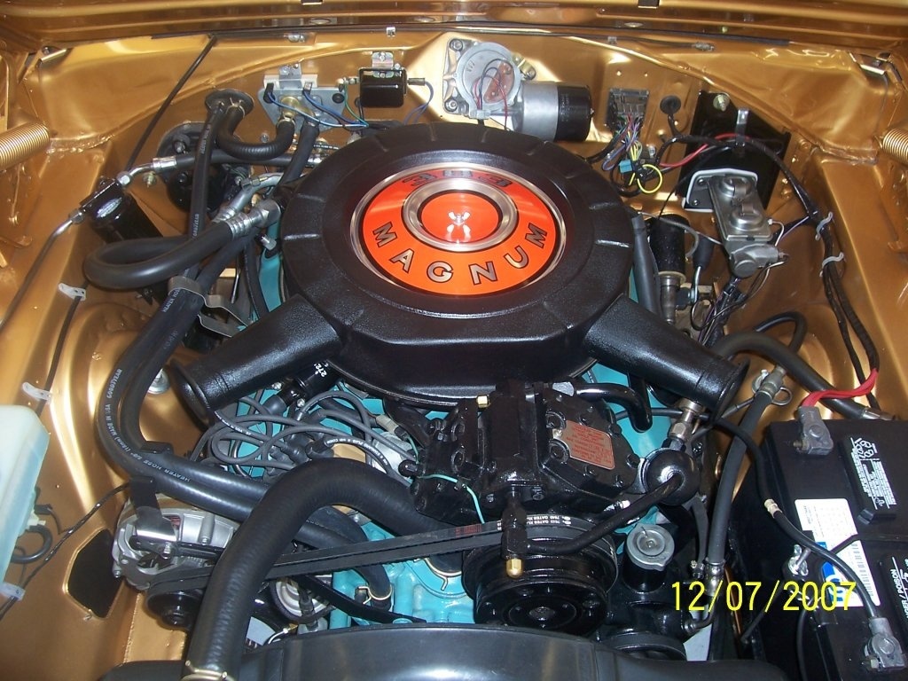

I was talking about the setup in your link. Do you have an electonic "box" that's driven by the modified distrib? Boy, didn't realize how much the price has gone up on those kits. The stuff in my garage might be worth more than I realized.

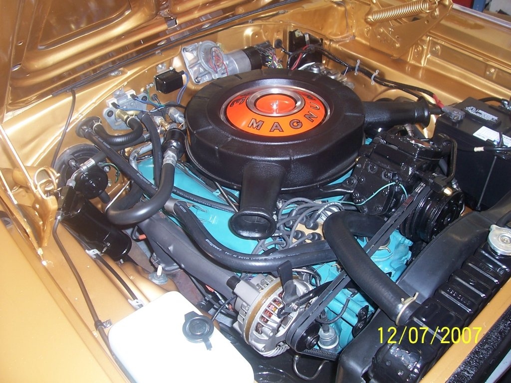

Sorry I'm poor on this end of the vehicle, can you tell from these photos what I have?

747, you make many good points. Carb selection sure depends on the engine/drive train combination and main use. Race carbs are surely more adjustable. Take a look at post #17 to see what OP is dealing with.
