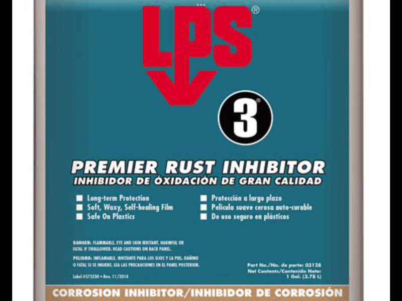

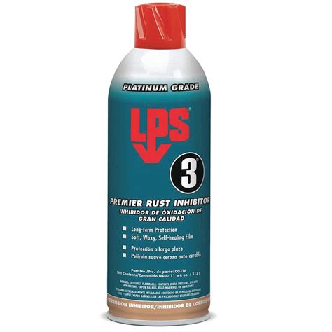

LPS-3 and a plastic bag closed up with no holes in it.
Yes! LPS-3 is like a Cosmoline for long term storage. WD-40 will evaporate 100%.
Where are you guys buying LPS-3? Used to be in all the stores around here, but not anymore.
I used to buy it through MSC when I was working and didn't have to pay for it! I think Grainger carries it.
So this stuff good for spraying into all the bores and lifter galley? Then bag it up tight?
Is it a pain to clean out when ready to use block?
No, just use Kerosene or Mineral Spirits. Keep the block/bag off of the concrete floor!

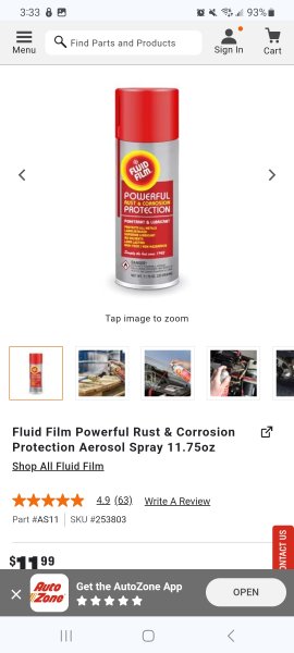

I heard it works well so before I put my block in a bag I hosed it down with Fluid Film .
That is the stuff I ended up buying since LPS-3 is not sold around here anymore. It has very good reviews. I coated a couple of engine blocks with it as well, but less than a year ago, so don't know how well it will work yet.

Bought LPS-3 at ACE hardware store couple days ago ,had a 7 dollar ace hardware reward card , save 7 bucks . Can get it from Amazon to ,cost more than Ace hareware.
For my money——Fluid Film. Stuff just works.
