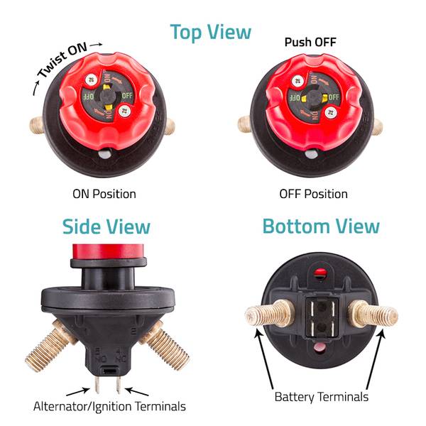

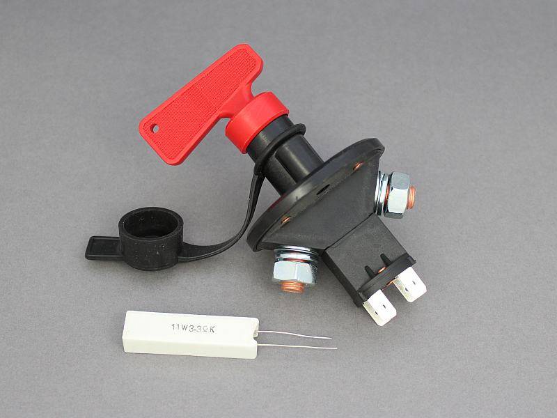

They cut the battery power, but as soon you also cut de ignition circuit ( blue wire coming out from ign switch ) you don't need to cut the alternator hot wire anymore because alternator will stop sourcing (alt field is sourced by the ign network). There are several brands. Dunno which on is the best but normally the ones I meant look like this:
ion-battery-and-alternator-kill-switch-combination-battery-and-alternator-kill-switch-add-image1.jpg
or this:

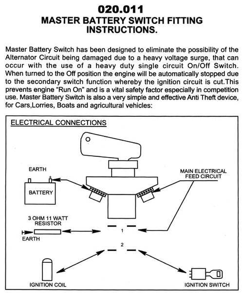

and they are wired like this:
