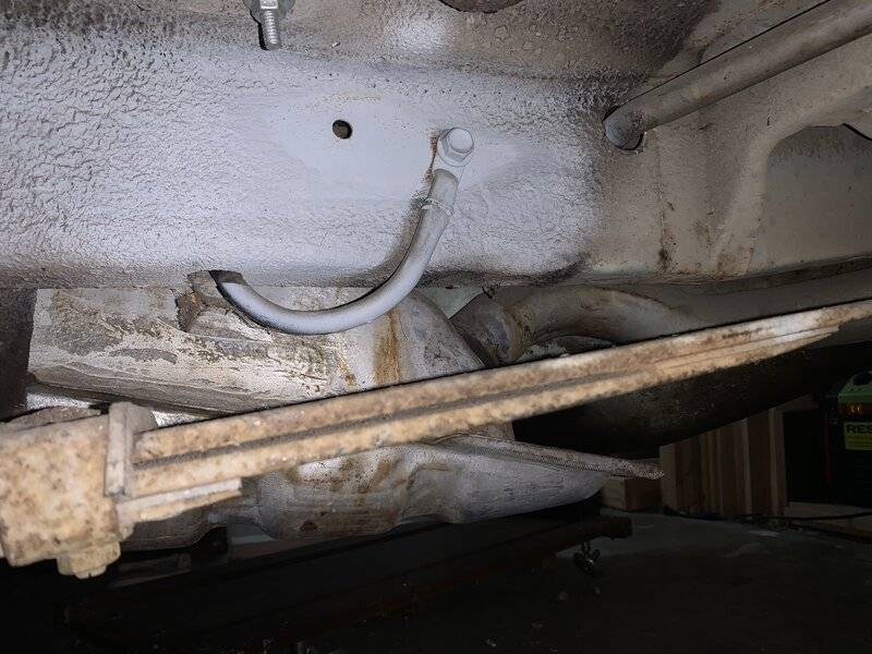

Ground is passing through one of the trunk pan gaskets and mounted to the frame. Pretty sure I sanded down to bare metal before installing but may be worth checking. Don't mind the overspray. Is this not a good location?
Make sure the engine is grounded well and the ground strap for the battery isn't bolted to paint....also check the relay. Might even cross across it's terminals to see if the starter will engage.

You need a #4 or larger ground from the engine to the chassis. Remember when battery is underhood the negative cable goes to the engine. Your starter draws approximately 200 amps. You need a ground cable to flow this many amps. Clean your battery terminals the battery posts.
Hmm right now I have a positive cable running from the starter all the way back along with probably a #12 cable running from ignition. Negative is grounded on the frame in the trunk. It was working without any issues so setup can’t be all wrong. I am thinking I just have to have a loose connection somewhere.
