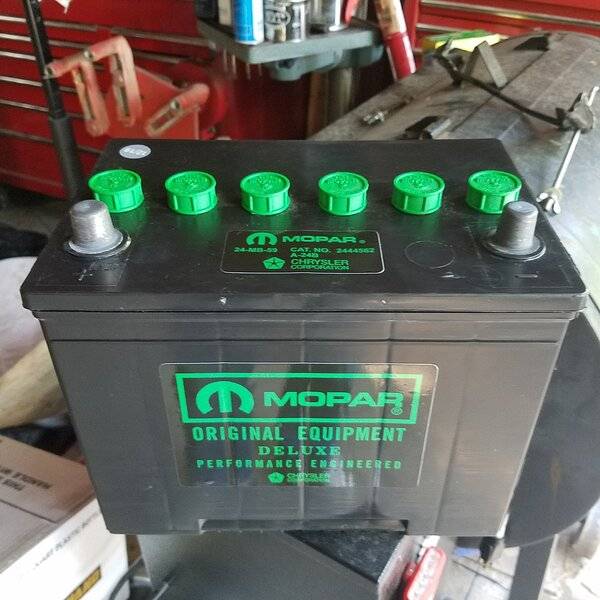

Just buy a battery and put it in. I have had OEM batteries last 8 years and Interstate's last 7. I don't like their green color under the hood with the Interstate's so I bought a Wal Mart Ever Start and put a cap and sticker kit on it to make it look more Mopar. It will probably last as long as all the rest.

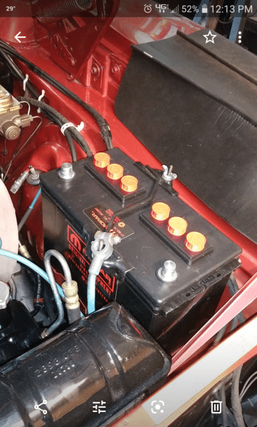

On my '67 R/T, I found a larger Group 30 tractor battery at TSC that had individual flat screw-in caps. I replaced these with red caps from a failed repro battery, and put a repro Mopar battery label on it. This battery is larger than a Group 27, so I had to modify tray, but should be fine for trunk mount.

Just buy a battery and put it in. I have had OEM batteries last 8 years and Interstate's last 7. I don't like their green color under the hood so I bought a Wal Mart EverStart and put a cap and sticker kit on it to make it look more Mopar. It will probably las as long as all the rest.

So you don't like Interstate green so you put the same green on a WM battery?
Did I miss something?
A green and white battery is different than a black battery with original looking green and black stickers. It would be hard to make that one look good.
Did the same thing with a group 27. For regular drives and cruise nights it has plenty of power with a warranty. Once I'm at a show like Carlisle I'll just swap it out for the old repro.
Exactly. Plus if it does fail when you are out of town there's usually a Wally World not too far away. Looks good there.
