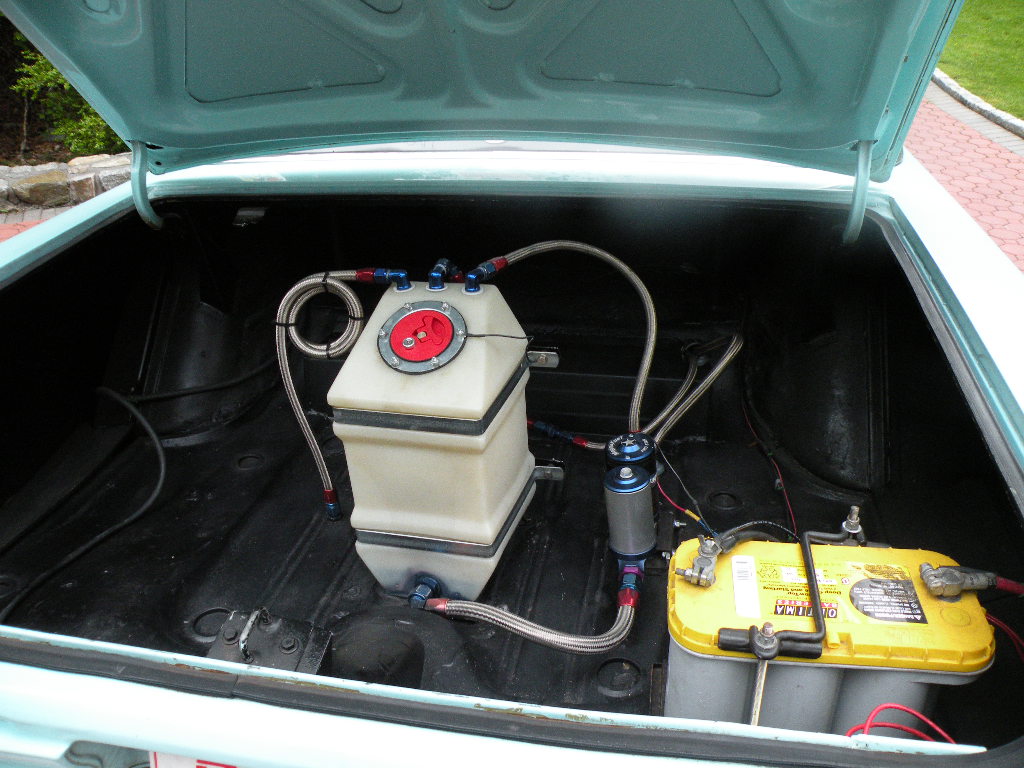

Heres a pic of my cars.

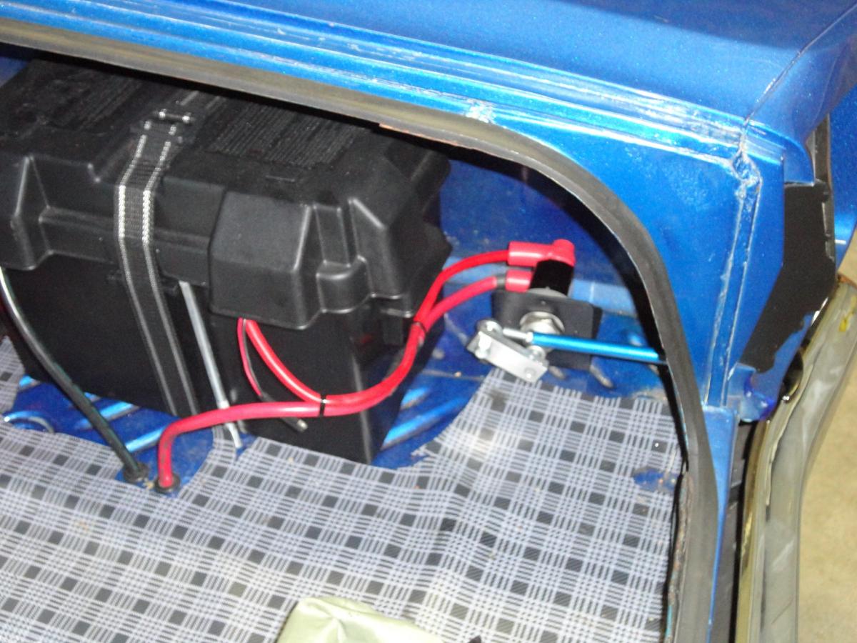

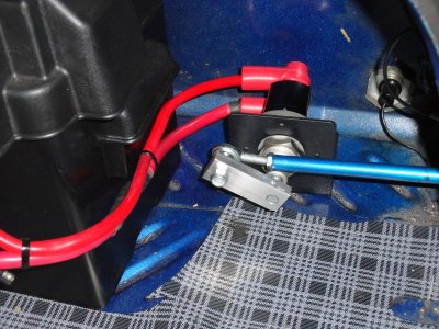

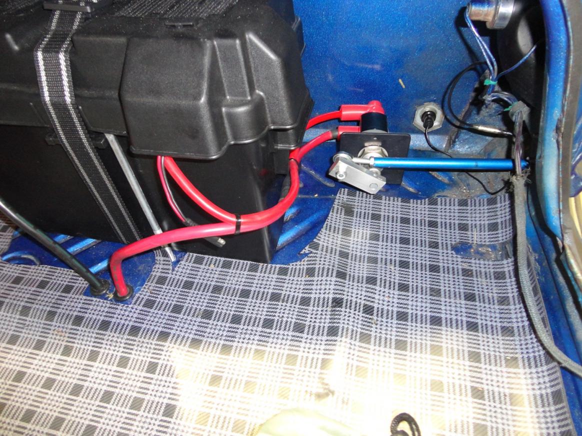

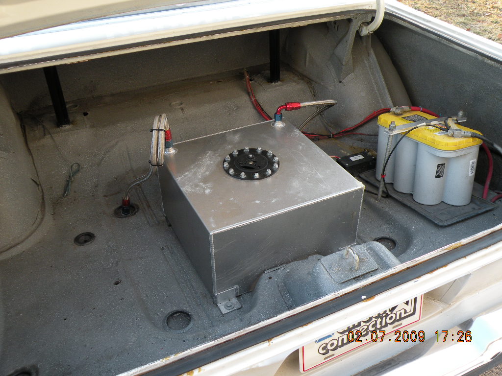

I'll show you mine if you show me yours!!!LOL

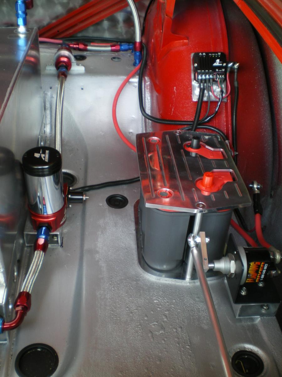

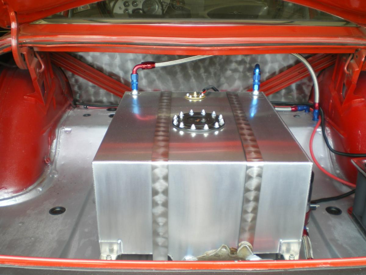

Mines bigger !! LOL !!
