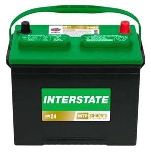

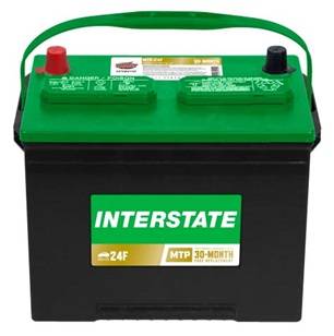

Most batteries have both options, depending on the number. For example a group 24 vs. a 24F will look like this:
Other than the posts, they're the same battery.

I'm pretty sure that the "F" in 24F does NOT stand for "Ford". I've installed batteries for AAA for 5 years and 24F is a very popular application for a lot of different non Ford cars/trucks. However some Fords do take a 24F.
I believe the "F" stands for flipped. Referring to the terminal positions. 24 would be the same battery as 24F except the terminal positions are reversed. In some cases a 24F could also be referred to a 24R with "R" meaning reversed.
