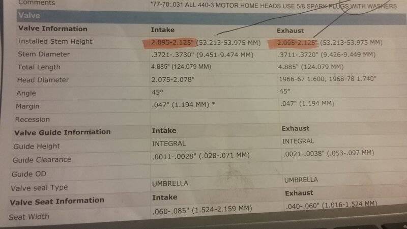

on my sheet it say's 2.095-2.125 intake and exhaust, installed stem height. specs from chrysler.

2.095"-2.125" Installed stem height
The problem with that is, it doesn’t guarantee the tips will be even.
I’ve seen many factory Mopar heads where the factory spring pads vary in height by .025-.030 or more.
You could have the tip to pad height be exactly the same on two valves next to each other....... and have the tip heights be uneven by .030”.
