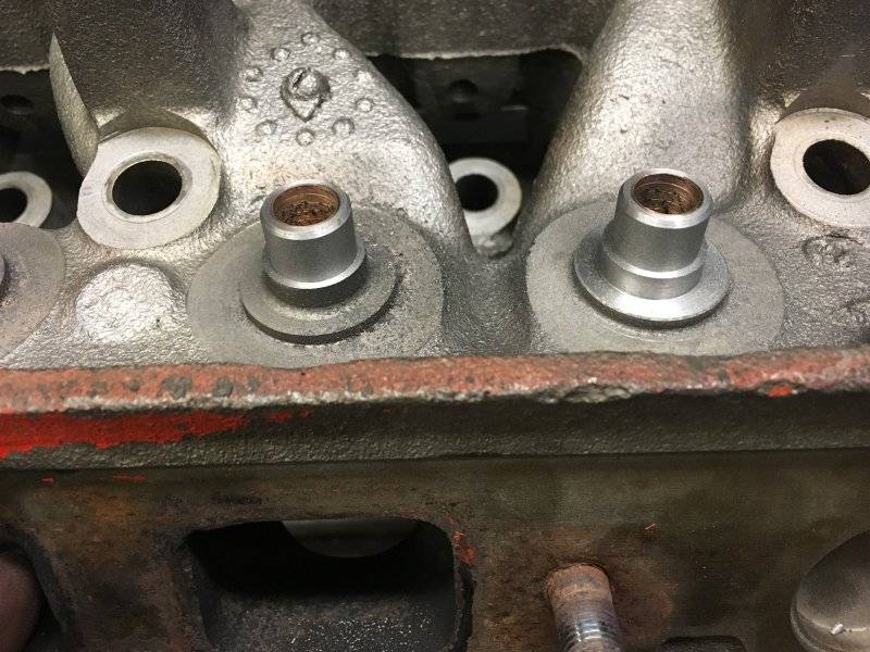

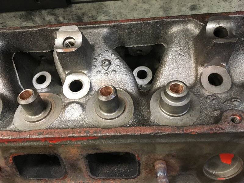

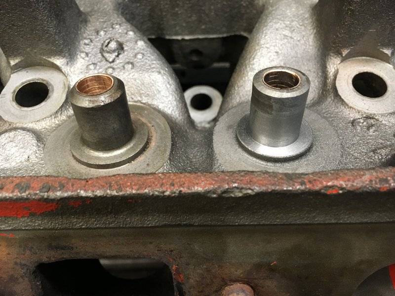

I don’t know if this is an optical illusion or what, but it looks like there are “humps” on the tops of the intake runners on whichever head that is.
I don’t recall ever seeing that before.
What’s the casting number on that head?
New day ………fresh look at it………it’s an optical illusion(to me).
I was seeing the roof tapering down towards the spring as being a raised area.
That’s what you get when you’re analyzing pics on your phone……… carry on.
