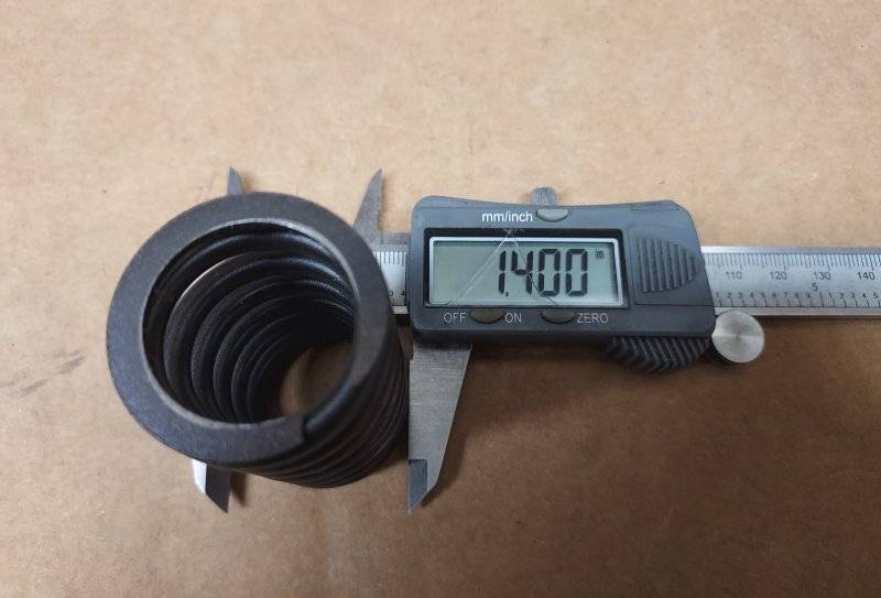

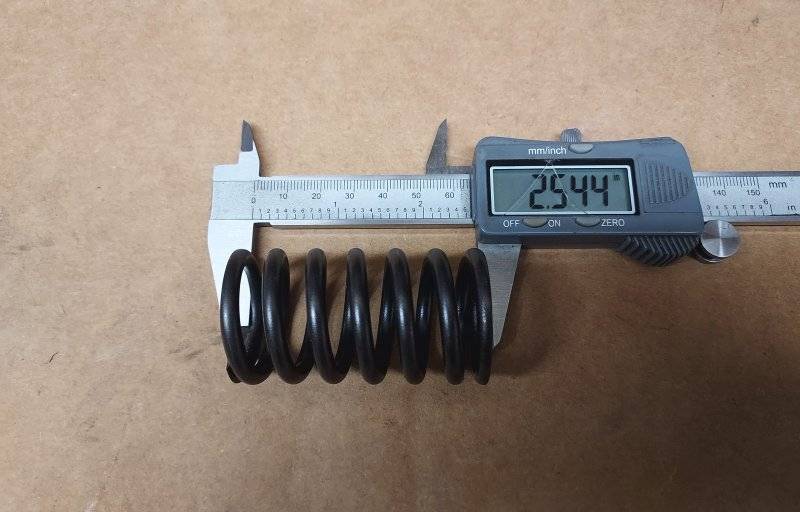

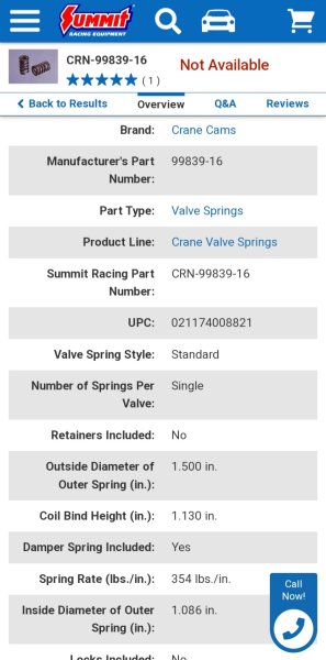

The new heads have slightly wider diameter single springs with dampers and was told they can handle.480" lift.
Does anyone have an idea of standard spring diameter and how these compare? Just trying to figure if the springs are up to the job before installing.
Springs on 452s when measured with caliper across diameter are almost 7/32" (5./mm) Springs on 906s are 13/64"(4.8mm).

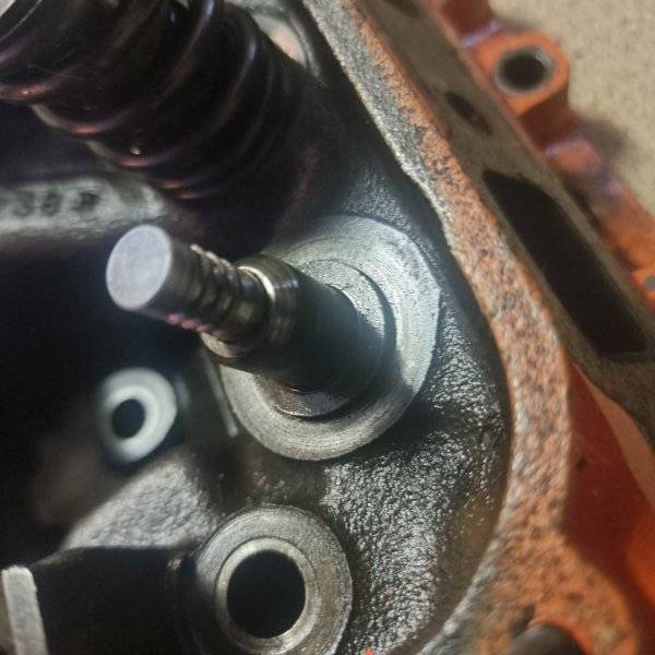

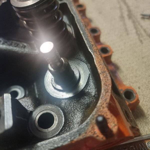

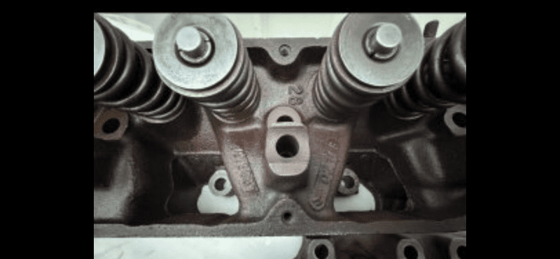

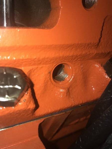

From pics: 906 head with removed valve;, is this a shim on the guide with spring removed, ( cant remove so assume it isn't but trying to figure if shims were installed on old heads).

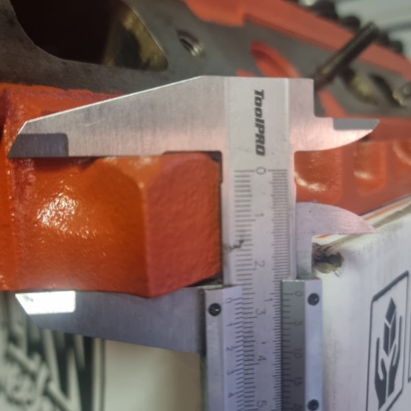

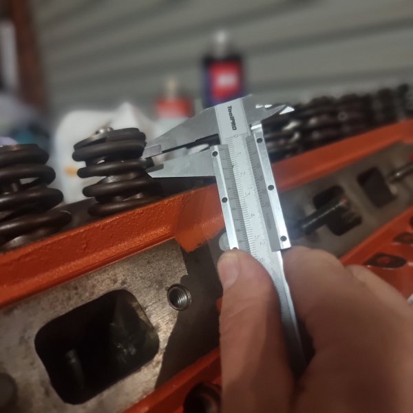

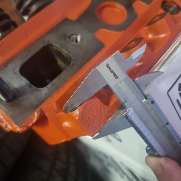

The heads are the same thickness where the caliper is in the pic.
Does anybody have a standard head they could measure at the same spot. Im trying to see if the heads are shaved and if rocker arms would need shims( none were installed on the original heads)? Measurement on my heads is1/1/64" roughly ( 25.8mm).
I have been watching Nicks videos on youtube and he says 120lbs closed and 230 -280 lbs open spring pressure is good for a 440 with a .450 or .460 lift cam.
Im thinking this is a good guide considering the cam specs are unknown. The 440 is a hp block and may even have the original cam but who knows,any thoughts on this?
