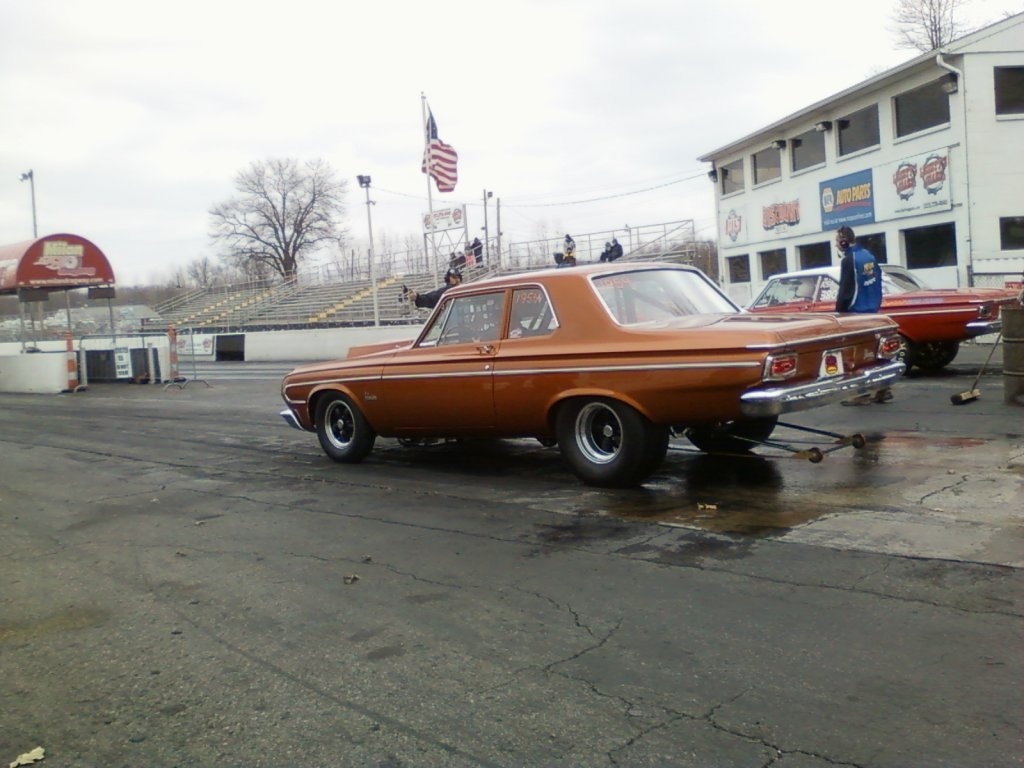

      Doug is right. The 727 I built in my 63 is more stock then you would think. And being I worked at a Dodge dealer for 24 years and did trans work I have a few extra Mopar 727 parts around my garage. I use all stock clutches and steels in my 727 in my 63 street/strip car. The only major changes I did was the Turbo Action reverse manual valve body and a bolt in sprag (overrunning clutch) along with a Luppo Dynamic 9.5 converter. I knew I was only going to race my car a little as I only get to race about once a year as its mostly all street miles and I dont street race the car. In fact I drive it pretty easy most of the time and just wind it out a little now and then. I keep my racing to the track. But my 727 has been in my 63 since 2006 and it still works like new and can be driven to the track and run 10.70's and 80's. Most mild Mopar street cars dont need a $4000 dollar 727. They just need a good built mostly stock 727 with a few mods as Doug said. If your building a 9 second race car then sure you will update to some stronger parts. Heck I even have run the 3 disc front clutch in a low 11 second street car that has been fine for many years. But its a street car thats not raced every weekend and mostly just driven normal. Ron
