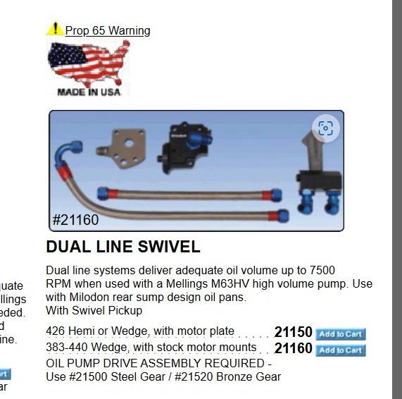

There is a longer shaft and there is a longest shaft. That system takes the longest. It takes a Milodon 21500. (It is 7" under the gear.)
So, I went to the Milodon site and the only kit that uses the plate is Dual Line Swivel PN#211160. At the bottom, they list 2 intermediate shafts steel/bronze so These should be longer appropriately.
1) Steel PN#21500 Milodon 21500 Milodon Oil Pump Driveshafts | Summit Racing
2) Bronze PN# 21520 Oil Pump Driveshafts - milodon 21520 KEYWORD - Free Shipping on Orders Over $109 at Summit Racing
Yes thank you. Looks this is the number to look for.
