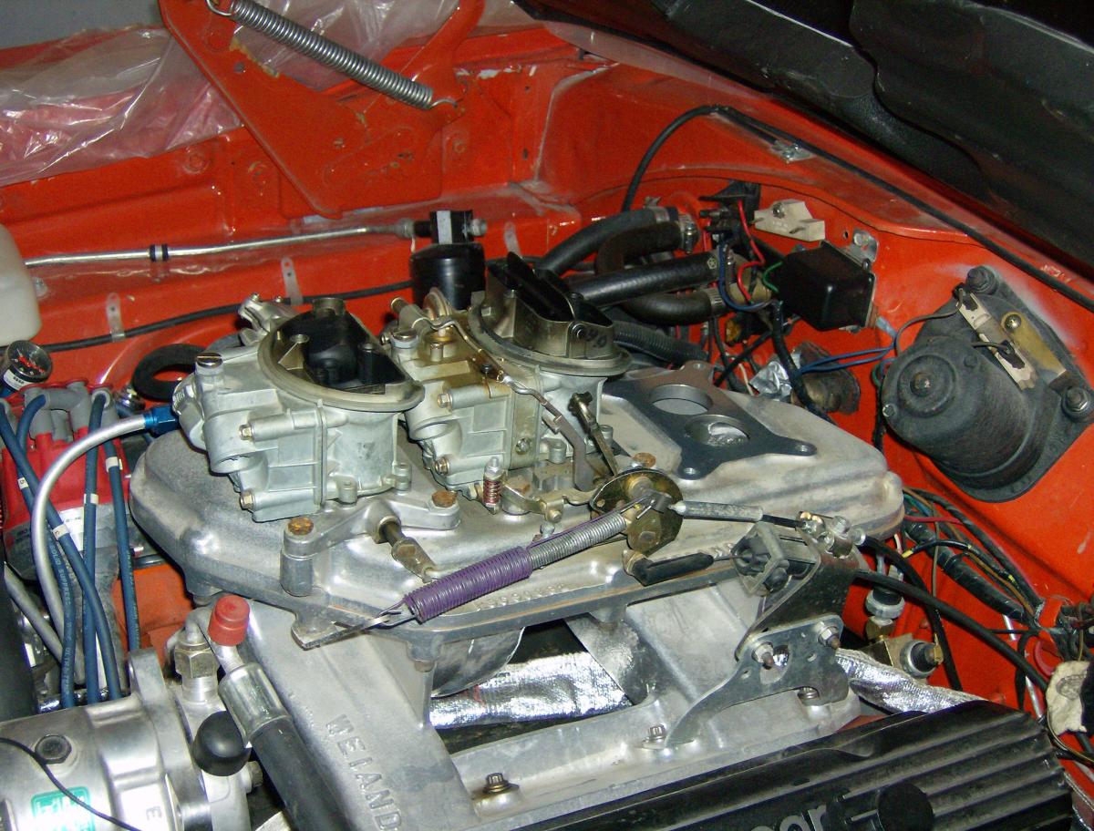

Temp guage is correct .180 thermostat. Electric hhr fan .440 engine new fresh engine about 1000 miles on it. Wieland six pack intake gets up to 220 in traffic.cooling sDidn't have this problem till i changed intake so i think i'm lean.Cooling system clean.Putting it on the dyno to get the center carb adjusted in may.I have a high volume water pump.

If you think your running lean put it a little on the rich side and see if it helps but don't go to crazy you don't want fuel wash....(Excess fuel washing the oil off of the pistons) It's better to be rich than lean...Don't forget that most electric fans only pull air through the area of the rad that they are mounted to.It's better to mount it an inch or so away and mount a shroud to get the full benefit of the fan by drawing air over the entire surface of the rad and not just an 18" hole in the center.Hope that helps :)

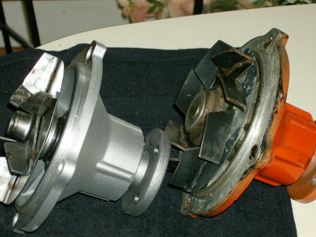

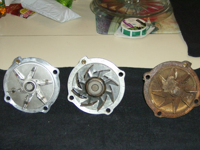

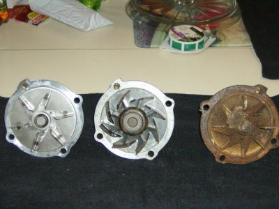

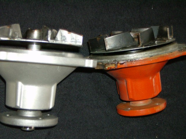

HPIM0162.JPG Trying a different water pump .The rusty one is a old one i had laying around to show how a stock one looks.The center one i had in my engine. 1st one have put in the engine will be trying the one out.
The one on the left is what the "high performance" motors would have had. The 8 blade is for A/C equipped cars. It's easy to out-think yourself sometimes. The 8 blade may circulate the water to fast for it to be cooled properly
i just went throught that, it was running hot with the 6 blade, changed to the 8 blade seems to run cooler at idle... my 2cents..

sorry to bring back an old thread, but whick direction are these pumps pictured supposed to spin ?? i ask because i removed my pump and it looks exactly like the one one the top right except the blades are going in the other direction ... and the car runs hot !! the crank spins clockwise, just wondering if maybe i have a reverse direction water pump ??
