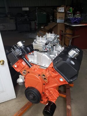

Some of you may frequent Moparts and happened upon my post entitle 572 Hemi Saga.

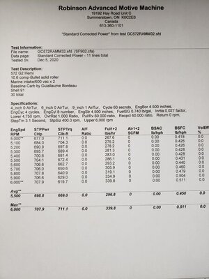

Basically I had a customer bring a 572 hemi in to dyno that was built by another fellow that some here would know. Long story short the engine was a mess both inside and out. I was tasked with making the changes the owner wanted with some artistic freedom of my own. Here it is before and after. Oh and getting very very close to having this back on the dyno. J.Rob
Did u do many changes from the original build? Thanks. Kim
The only quick way I can say this is by listing what was kept from the original build.
What was kept:
Block
Crank
Rods
Head Castings
Camshaft
RBRE Rockers/pushrods
Everything else was changed all the way to the headers. J.Rob
