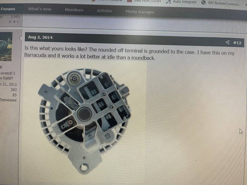

I am specifically asking about the field terminal I grounded. Does it matter which one? I saw one post that said ground the “rounder” terminal as seen in this pic but my terminals were both the same

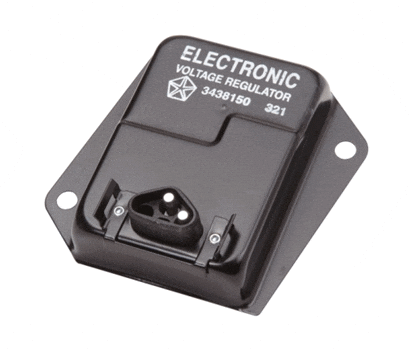

If you have this style voltage regulator, be sure one field terminal on the alternator is grounded to the case and the other terminal is open. Does not matter which one. Verify with meter to confirm. This will eliminate any confusion with the shape of the case.
If you have this style regulator, both fied terminals should be open and NOT grounded. Again, test with a meter and verify.
If the square-back is assembled correctly for a ’70 and up application, it does not matter which terminal is grounded for it to be used with a mechanical regulator, pre-’70 application. Some remanufactures will remove an insulating washer from one terminal/brush assembly screw, substitute a metal washer to ground the terminal then clip off or “round off” the terminal to prevent a wire from being connected to the grounded terminal. When boxed as a pre-’70 replacement application.
