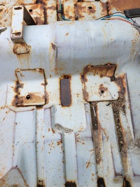

You can drill out spot welds and cut the welds on the edge of the console mounts carefully with an angle grinder and leave the tunnel mostly undamaged. There should be a couple brackets on the floor the bucket seats bolt into. You can cut them off just like the console mounts. I'm pretty sure you'll have to end up drilling holes but shouldn't be a big deal. Take some measurements of the holes on the bucket seat car. Make sure you get the lower linkage that connects the console all the way to the transmission. Might have to crawl under the car to get that part.

The seat brackets are below the floor.
My guess is there is no difference between a bench seat floor and a bucket seat floor as I recall having extra holes in mine.

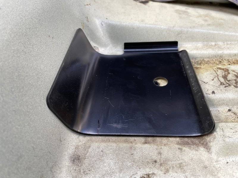

Newer car floors, when changing to buckets require reinforcement doublers on the holes closest to the tunnel, 4 places.

These are the brackets i was mentioning.
Yeah, I have never seen a bench seat in a '67 Charger. We need pictures to see what is going on. If your car has reinforcement plates welded to the front floor, near the transmission tunnel, your car originally had bucket seats. The console became an option in 1967, so many of these Chargers were built with a "Buddy" seat between the buckets, or nothing at all. In either case, an automatic car would have column shift.
