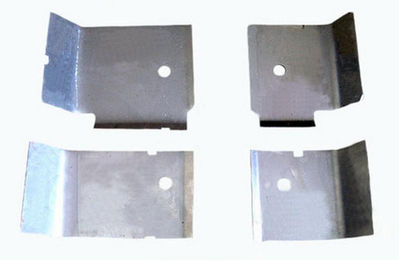

You should also install the 4 plates that weld to the floor pan, these help beef up the inner stud holes and prevent tearing on hard launches.
...or you could use the seat nuts with the extra large, extra thick captive washer that can be easily found on 5th Avenues.
